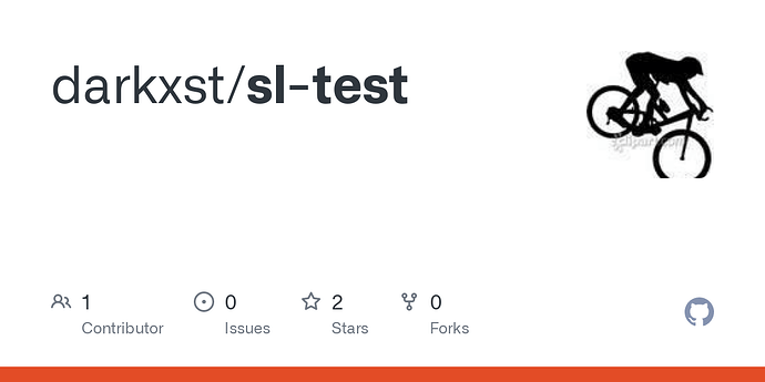

Not credited but that looks like it is a more or less a copy of the “sl-test” proof-of-concept by @darkxst

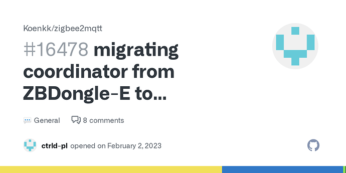

If using Zigbee2MQTT with a Silicon Labs based dongle then you should really always manually backup Zigbee network with zigpy-cli command tool before flashing firmware and restore that backup after flashing firmware. The reason is that Zigbee2MQTT does not yet support backup and restore of Silicon Labs, see this related discussion with info on how to backup and restore:
