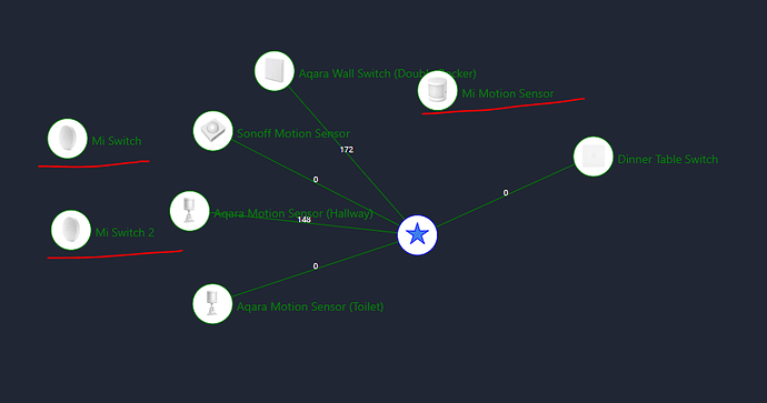

Current topology:

Just an update after the migration from P to E.
Mesh seems responsive and faster. I had to repair about 4 routers (out of 60) as they dropped off within 1-2 days but was straight forward.
Signal strength seems to be much better but I am not sure if this is just the way SL calculates it vs TI.
One thing I noticed however is there are more warning in my logs, mostly timeouts but also a topology scan fail. Not sure what that means, tried searching online with little progress.
