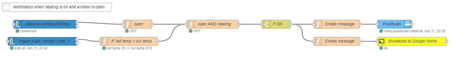

One of the applications with the sensors when your alarm system is off anyway:
Get a notification when the heating is on and the windows are open.
Build with Node-RED, interacting with Home Assistant platforms such as binary sensors.

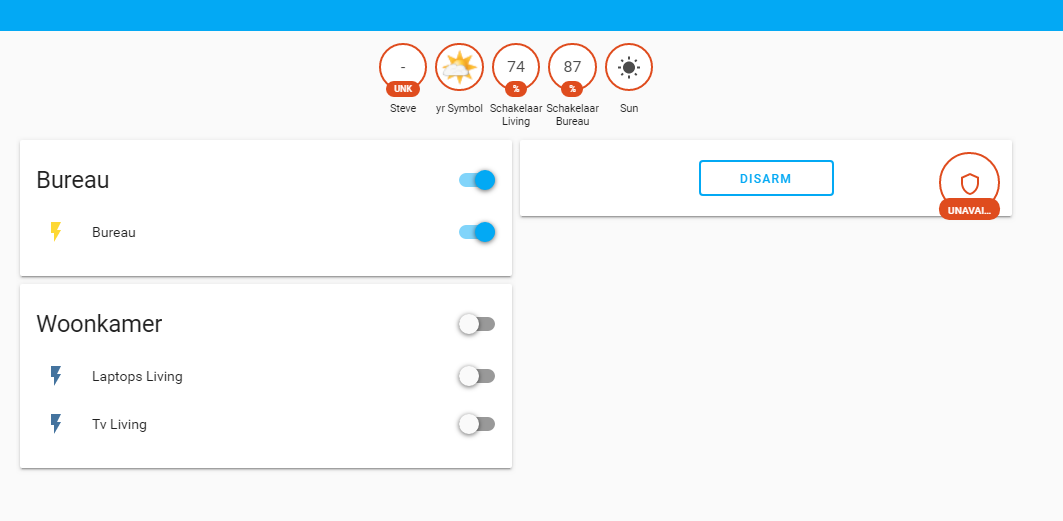

alarm_control_panel:
The only think, if you remember, is that the alarm is arming/arming home/disarming without the code entered in HA alarm card - just the buttons.
