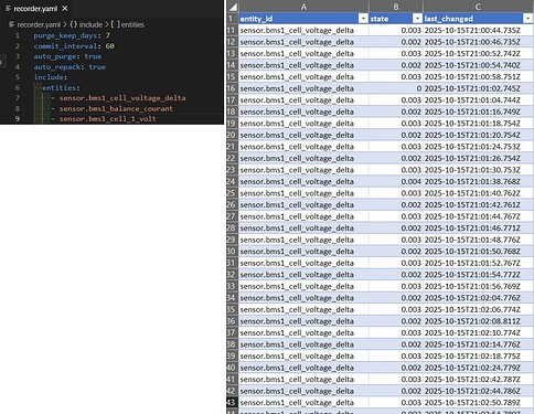

I’d like to plot the graphs for Cell voltages. But values are updated every 1-2 sec. In case they are included into the recorder, HA database becomes large in short term.

Not a cloud. It impacts HA database size and CPU load (as it needs to frequently write a lot of data to SD card).

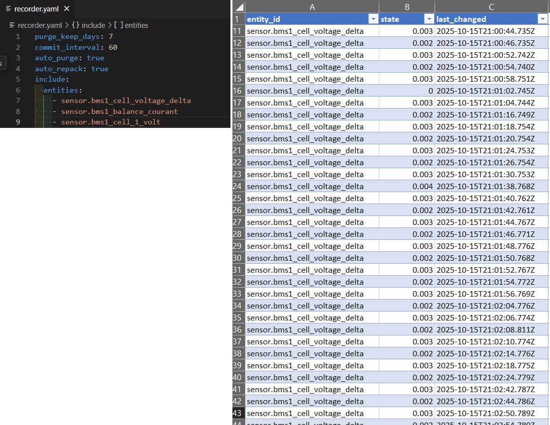

See some examples attached. I added few entities to recorder
updates are approximately every 2-4s. Sometimes it’s helpful. But not when I want to store all this data. Also system becomes very unresponsive if all Cell values are included into Recorder. I had CPU load up to 50% on RPI5.

Timeout of 60s (even up to 5min) between readouts should be completely fine to create precise graphs for Cell Voltages.

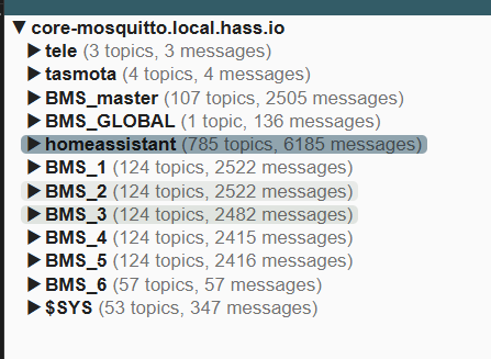

After restart HA didn’t work what I expect 6 BMS in parallel.
Master ADDR is 00000, the rest slaves 1…5.
On PC with Jk-monitor work perfectly.
Connection is via RS485 - USB.
Last JK-BMS not have same entities like others.
configuration is:

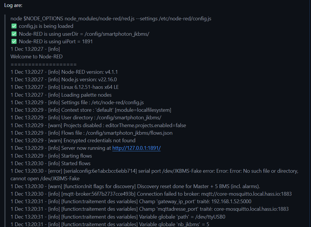

Can someone help with indentify problem? thx
1 Dec 13:20:31 - [info] [function:traitement des variables] Variable globale ‘use_gateway’ = false
1 Dec 13:20:31 - [info] [function:traitement des variables] Variable globale ‘gateway_ip’ = 192.168.1.52
1 Dec 13:20:31 - [info] [function:traitement des variables] Variable globale ‘gateway_port’ = 5000
1 Dec 13:20:31 - [info] [function:traitement des variables] Variable globale ‘communication_debug’ = true
1 Dec 13:20:31 - [info] [function:traitement des variables] Variable globale ‘bms_broadcasting’ = true
1 Dec 13:20:31 - [info] [function:traitement des variables] Variable globale ‘CAN_bus_usage’ = false
1 Dec 13:20:31 - [info] [function:traitement des variables] Variable globale ‘mqttadresse’ = core-mosquitto.local.hass.io
1 Dec 13:20:31 - [info] [function:traitement des variables] Variable globale ‘mqttport’ = 1883
1 Dec 13:20:31 - [info] [function:traitement des variables] Variable globale ‘mqttuser’ = serghei
1 Dec 13:20:31 - [info] [function:traitement des variables] Variable globale ‘mqttpass’ = •••••••••
1 Dec 13:20:31 - [info] serial port /dev/JKBMS-Fake closed
1 Dec 13:20:31 - [info] [serialconfig:6e1abcbcc6ebb714] serial port /dev/ttyUSB0 opened at 115800 baud 8N1
1 Dec 13:20:31 - [info] [debug:port used] /dev/ttyUSB0
1 Dec 13:20:31 - [info] [debug:host used] undefined
1 Dec 13:20:31 - [info] [debug:JK-BMS response: ]
<Buffer 55 aa eb 90 02 00 a3 0c a3 0c a5 0c a5 0c a5 0c a6 0c a5 0c a3 0c a5 0c a5 0c a5 0c a5 0c a5 0c a6 0c a5 0c a5 0c 00 00 00 00 00 00 00 00 00 00 00 00 … 14 more bytes>
1 Dec 13:20:31 - [error] [buffer-parser:Trame 3] RangeError [ERR_OUT_OF_RANGE]: The value of “offset” is out of range. It must be >= 0 and <= 62. Received 80

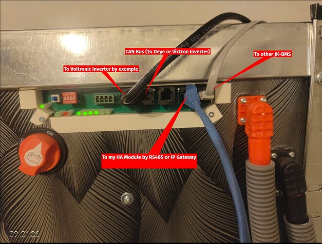

Very excited to try this addon. Just quick question on connecting through RS485 (my preferred approach given my RPi with HA is right beside the BMS). The CAN port (second RJ11 from left) is already used to connect to my Deye inverter. Is it possible to connect to any other port or would I have to use some kind of splitter?
My add-on module is designed to be connected to one of the two RJ45 ports on the right. They are labeled RS485-2.

I just updated to firmware V15.41 (JK_PB2A16S20P) and am getting the same error:
[error] [function:URL standalone] TypeError: Cannot read properties of undefined (reading ‘0’)
I haven’t successfully managed to get recognition on MQTT after a few days of trying. I am however getting successful amperage readings in the detailed debug logs so the data is definitely coming in.
Any help would be appreciated.
Edit: Issue seemed to resolve itself for me and my MQTT now sees all the entities.
