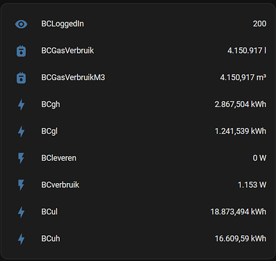

This is what I have so far, I could add 3 phase and electricity cost:
Here is my final config for the above picture (it is set up to be used with the home assistant energy menu)
