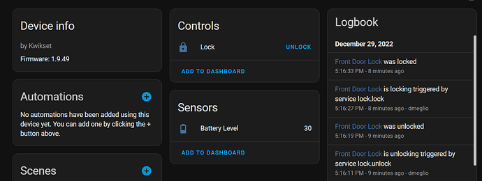

I mostly have it working now, just need to do some error handling and testing:
It supports all the built in lock entity features locked/unlocked/locking/unlocking and jammed status. I can also pull the battery level
Seems to be working pretty well for me, GitHub - dcmeglio/home-assistant-kevo: Kevo Custom Component for Home Assistant let me know if you hit any issues and also if anyone is using a Baldwin or Weiser lock let me know if it works. I only have Kwikset to test with.
