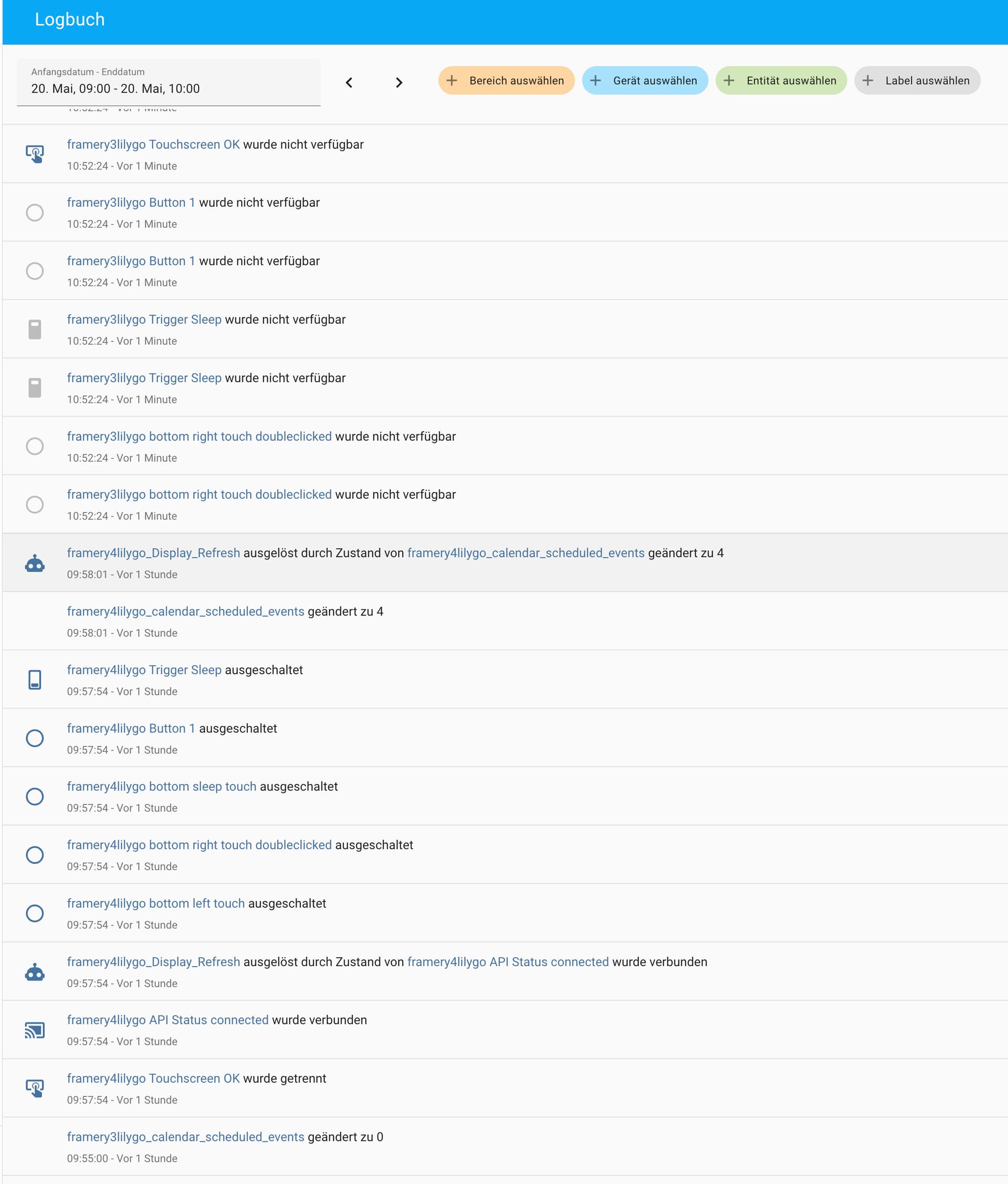

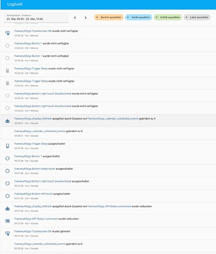

I do not know if I am here at the right spot. I am developing a ESPHome device, that connects to HomeAssistant. In HA I have scripts running that calculate the next deep sleep of the ESP and how long it should be. I will have “some” of these devices. I do have the ESP YAML working for “some” device, and I do have the HA YAML for each device as a yaml. Both are automatically generated if I provide a new device.
At the moment I am debugging. My aim is in debuggin to concentrate on one device. But I do need to see “everything” that has to do with this device. In the logbook I can choose a device, which gives me the sensors, but not the automations. At the moment I test with two devices, and for me it is quite confuding to oncentrate on one devide, as you can see in the screenshot.
Is there any way that I automatically give my automations a “device label” in the automatios yaml configuration? I did not find a way. Again: Sorry if this is not related; if related: please add this feature :slight_smile:
many thanks
Juergen
