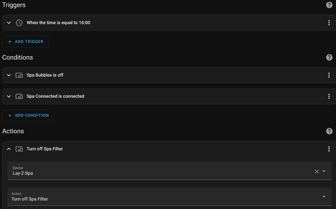

What I don’t get is how to automate that the filter is e.g. being turned off every day at 8pm.
I can’t find any suitable action which allows me to switch “switch.spa_filter” from “on” to “off” based on a timer.
Anyone any idea?
You’re probably looking for something like this:
The action at the bottom is a Device action.
Exactly. Unfortunately, it doesn’t list any of the switches of the spa when adding a Device action in the Actions area:

Hey @cdpuk
thanks for your reply and the screenshot. However, Device action doesn’t list any suitable linked device from the Spa, hence can’t select the switch.
In the entities its being listed:
However, trying to make use of this, it doesn’t show up in the Automations → “Device action”:
Oddly, I can find it when configuring it in my Dashboard:
So, why does the Automation can’t see the device/entity?
You need to find “Lay-Z-Spa” in the “Device” field. In HA terms the integration typically exposes one device which has multiple entities (the filter switch being one of them).
Once that “Device” field is set correctly, actions for the related entities will be displayed like my screenshot.
