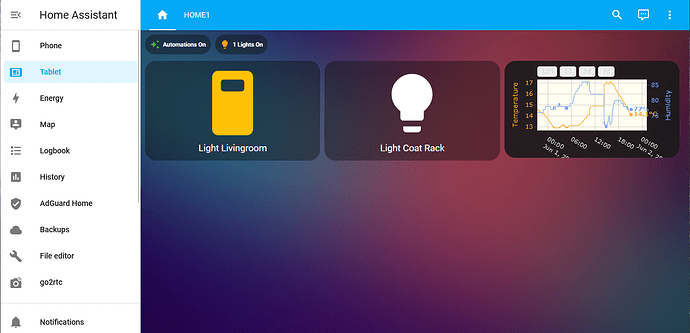

I would like to use the grid layout to setup a tablet dashboard.
I’ve started with a very basic one with a header row and a left, middle and right column below it. I place 3 cards in each column just to test it out. Everything works as expected.
Dashboard YAML

Now if I replace the card in the first column with a custom:bom-weather-card I run into problems. In edit mode it looks like I expect
Dashboard (with weather card) YAML

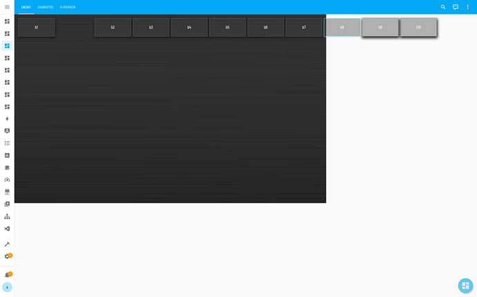

I have a background that scales perfectly on a desktop but it only displays partially and looks smaller on a tablet. This behaviour on a tablet ā€œappearsā€ to be linked to the layout card.
If i remove the references to the layout card the background scales across the whole screen
My theme code: (background.jpg is 1920x1200)
lovelace-background: 'center / cover repeat fixed url("/local/background.jpg")'
The code in the dashboard:
views:
  - title: energy
    path: energy
    theme: new-theme
    type: custom:grid-layout
    badges: []
    cards:
      - type: custom:layout-card
        layout_type: grid
        panel: true
        layout_options:
          grid-template-columns: >-
            150px 150px 150px 150px 150px 150px 150px 150px 150px 150px 150px
            150px
          grid-template-rows: 100px
          grid-gap: 0px 0px
        cards:
          - type: custom:button-card
            show_name: true
            tap_action:
              action: navigate
              navigation_path: /dashboard-tablet1/general
tablet dimensions
the result:
