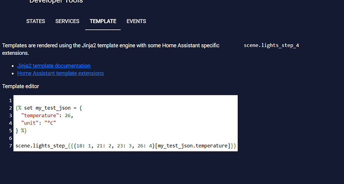

what I meant was debugging/ evaluating the output of an expression like:
 scene.lights_step_{{ {18: 1, 21: 2, 23: 3, 26: 4}[trigger.above] }}

so as to check the expected output of the expression if sensor.ambient_light is at say 24
You can use the json example with a little tweak in the template editor.
{% set my_test_json = {
  "temperature": 18,
  "unit": "°C"
scene.lights_step_{{{18: 1, 21: 2, 23: 3, 26: 4}[my_test_json.temperature]}}
Or more directly:
{% set trigger = {'above': 23} %}

It does however appear that the template editor feature has the ability pick true sensor values rather than using a static preset value …
The code you have shared sure is handy but I was wondering if there was a way to evaluate more complicated expressions (like your example) to see how they react to dynamic changes
The template editor constantly re-renders the template as you enter it. That’s why, sometimes as you’re entering a template it will say something about errors until you get it complete. So, say, you want to see how this renders with different values:
Just change the value in the first line. As you change it it will be re-rendered and the result on the right side of the page will update.
Or you could do something like this:
{% for value in [18, 21, 23, 26] %}
  {% set trigger = {'above': value} %}
{% endfor %}
Also if you have a template that references real entities, as they are changing, again, every time you change the template, the result will update, too. Sometimes I just put the cursor at the end and hit space, delete, space, delete, space, … To get it to update over and over again. :smile:
Does that answer your question?
