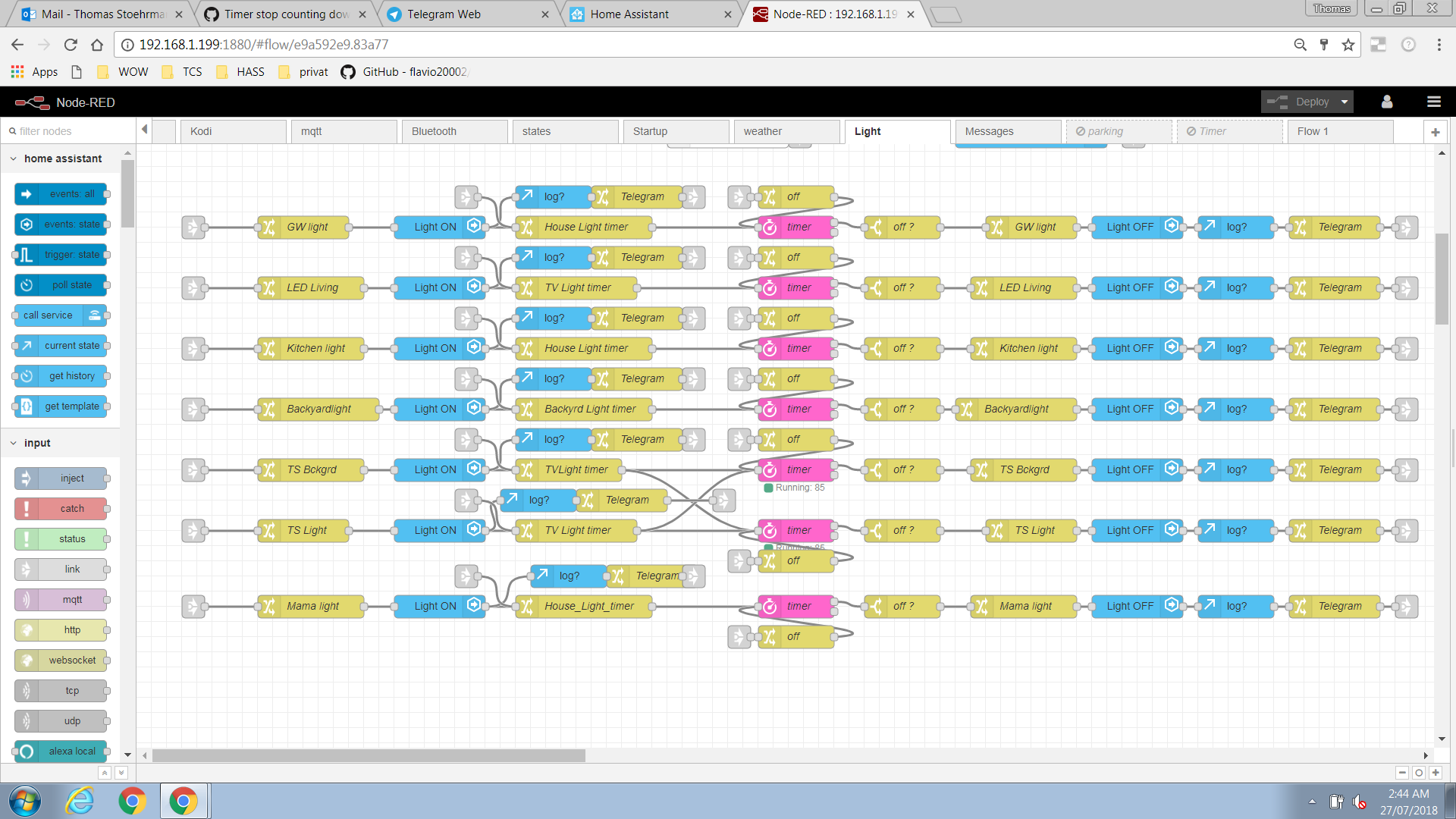

I have all my lights motion triggered by Xiaomy sensors (motion, door, button) than the lights stay on for a period of time (3-5min depending on room an day of time) before they switch off… this makes the live very easy :slight_smile:
Below is just the light section … looks more complex than it is :wink:
Hi, can you explain me the logic (what is house light timer, are you able to change iut from the frontend?)
Yes, “House Light Timer” in fact all the timer are Input_select where I have configure default times to be selected from.
See below my sleep timer, in case you want to remember your last selection after reboot, you have to comment-out the “initial” parameter and activate “Recorder” in configuration.yaml
