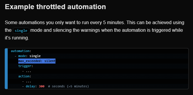

The automation is set in single mode, exactly to prevent that. I tested it quite extensively and never happened to me. There’s also a 200ms delay after the action, to throttle them.
mode: single
max_exceeded: silent
So I cannot reproduce the issue. Technically it shouldn’t happen, as per HA docs:
sometimes people like to break things…to test, obviously. :slight_smile:

Like I wrote in previous post, it has been configured in SINGLE mode. It works as described in HA documentation: it ignores new runs until the ongoing run is completed and it issues a warning (that I have silenced to not spam the log). So the loop can’t happen.
