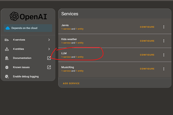

I’m getting this error when press action to test in developer tools
Failed to perform the action llmvision.image_analyzer. OpenAI provider is not configured
You will need to configure the OpenAI provider first (you’ll need an API key). Check the docs for instructions how to do that:
Not quite sure what you mean by “put names to faces in the output of llm vision”.
The only way I can think of to make llm vision “recognize” faces would be to have all the faces you want it to recognize in the input along the with image you want to analyze. If you enable include_filename and have the persons name set as the filename of your “face image” then maybe it could make an educated guess.
This setup would not use double-take though.
I already created an provider and still get the error.
