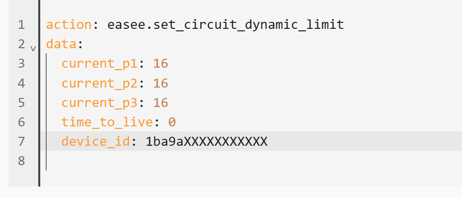

Hi all,
I’m trying to get this automation work.
Unfortunately I get an error message.
First of all: within the developer tab and actions I can change the current during charging.
Is there a code specialist :wink: who could help me?
I use the original code and in bolt the entities which need to be changed.
The Easee charger doesn’t have a number entitie…
Maybe: (easee.set_circuit_dynamic_limit) but that one doesn’t work…
The picture below shows within the developer which works when click on execute:
So which entity_id I have to use? for the number.go_echarger_XXXXX_am
In the code below I use ZZZZZZZZZZZZZZZZZZZZZZ for the entitie above
The lay-out isn’t perfect but thats not the problem
