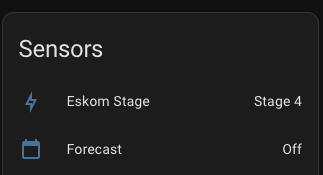

Hi guys,
Any idea why my Load Shedding integration will be showing unknown?
All seems to be working but just showing unknown for both Eskom Stage and Cape Town Stage?
Forecast = off

How can I turn on the Forecast again?
Somehow I turned it off and can’t find a way to turn it on again.
Thank you for the plugin/card.
