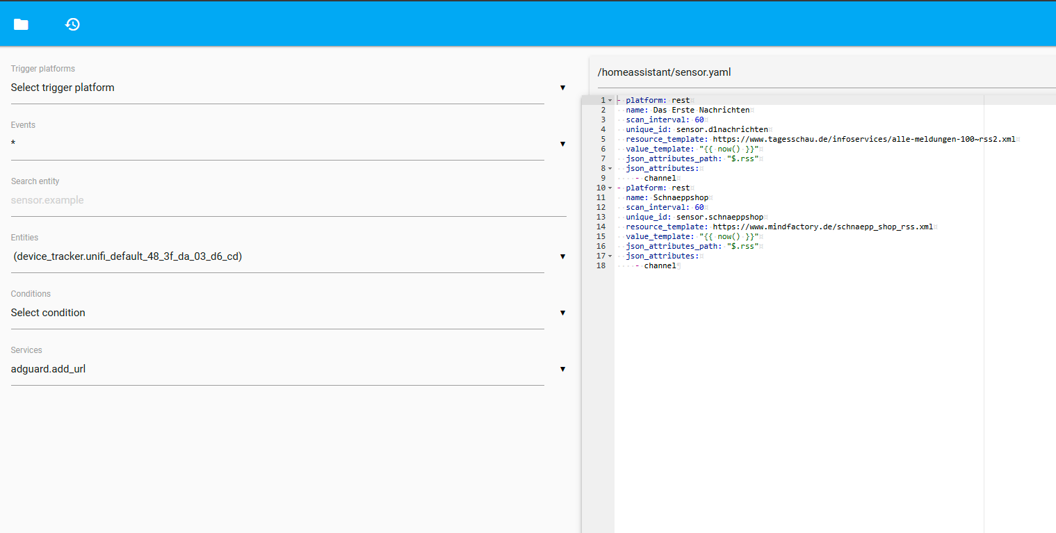

I have issues to extract the channel from a RSS as it looks like that:
„channel rdf:about=“tagesschau.de - Die Nachrichten der ARD | tagesschau.de”“
I set up the sensor template as in the Fox News example but get the error „ ‘None’ has no attribute ‘item’“.
Any ideas?
@Stuart11181 You can use this yaml to create the sensor for feedparser, then create sensors for the title, URL, and Image for each news article:
sensor:
  - platform: feedparser
    date_format: "%a, %d %b %Y %H:%M:%S %Z"
    feed_url: "https://www.tagesschau.de/infoservices/alle-meldungen-100~rss2.xml"
    inclusions:
      - title
      - content
      - published
      - updated
      - link
    exclusions: []
    scan_interval:
      minutes: 15
    show_topn: 20

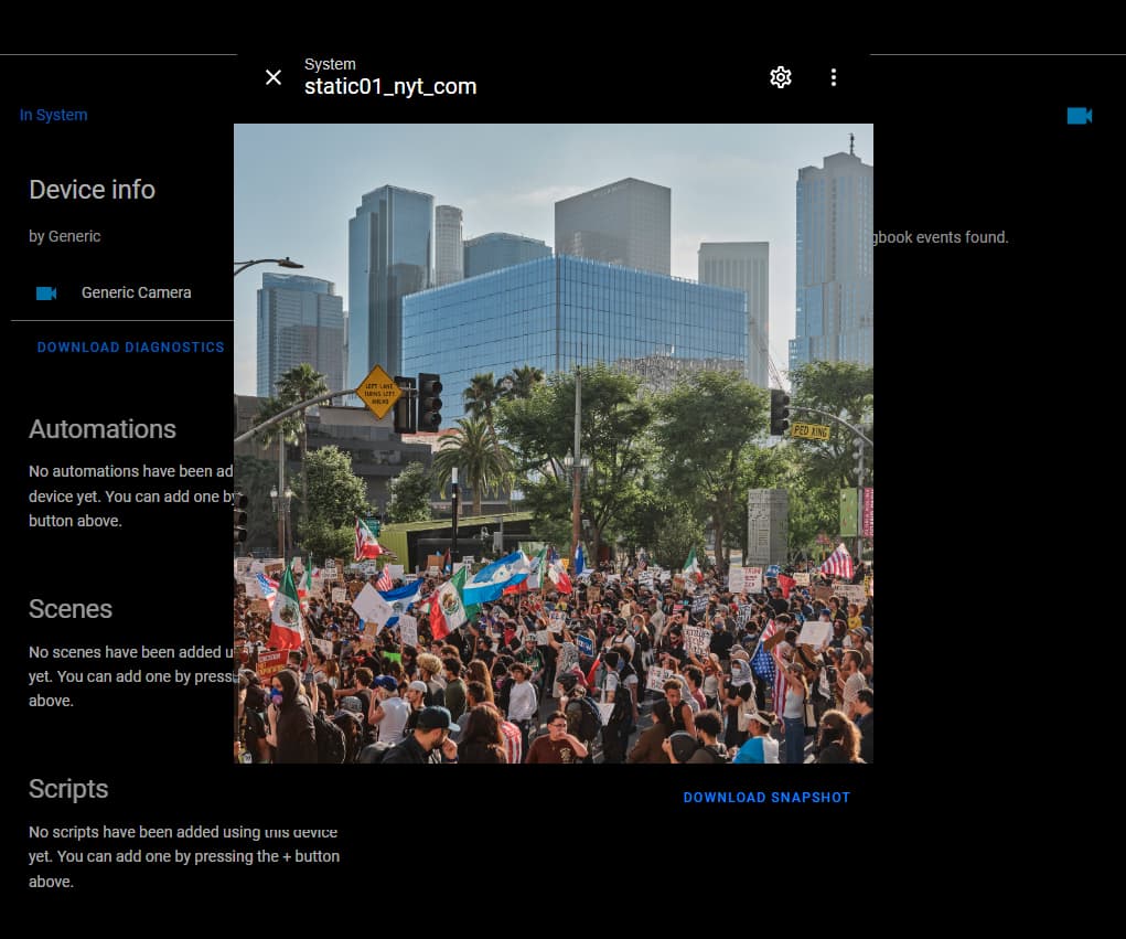

Any help would be appreciated, I cant get the images to display from the nytimes feed
https://rss.nytimes.com/services/xml/rss/nyt/US.xml
type: markdown
content: |-
  {% for story in state_attr('sensor.google_top_stories','channel').item %}
    <h2>{{story.title}}</h2>
    <table>
    <tr>
    <td>
        <p><img src="{{ story['media:content']['@url']}}"/></p>
    </td>
    <td>
       <p>{{story.description}}</p>
       <p><a href="{{story.link}}/">Link to Article</a></p>
    </td>
    </tr>
    </table>
    <hr/>
  {% endfor %}
which returns
UndefinedError: 'dict object' has no attribute 'media:content'
but i can see the object in the attributes list
Here you go! Creating sensors and using Generic Camera is how I was able to do it. It’s a weird way to do it but it works just fine!
Here are the sensors for the first 5 articles, which includes the Title, Link to Article, Summary and the Image:

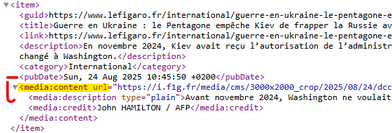

hey @kbrown01, since you seem knowledgeable in the subjet, I have a question.
I want to also add the image of each item in one of my .xml feeds, but the syntax is different, see https://www.lefigaro.fr/rss/figaro_actualites.xml
Unlike with foxnews, each <item> has another sub entity / group, <media:content> where the image is located, and I don’t know how to display that image in a markdown card.
Would you or someone else know how?
Thanks a lot :slight_smile:
@1aranzant … Use these:
Add these to your config:
- platform: template
  sensors:
    figaro_article_0_image_url:
      friendly_name: "Figaro Article 0 Image URL"
      value_template: >
        {{ state_attr('sensor.figaro_images_all', 'image_urls')[0] | default('') }}
    figaro_article_1_image_url:
      friendly_name: "Figaro Article 1 Image URL"
      value_template: >
        {{ state_attr('sensor.figaro_images_all', 'image_urls')[1] | default('') }}
(Rinse and repeat the template above for as many articles as you want to display)
- platform: rest
  resource: https://www.lefigaro.fr/rss/figaro_actualites.xml
  value_template: "OK"
  json_attributes_path: "$.channel.item"
  json_attributes:
    - image_urls
Then add this in Generic Camera under still image:
{{ states('sensor.figaro_article_0_image_url') }}
