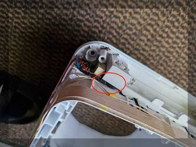

If you look at the battery compartment you will see the minus connector for the battery in front and the plus wire at the back. These connection points are soldered directly to the PCB using a metal pin.
Since you have to mount a diode from the battery to the PCB to avoid them being (over)charged all the time, I decided to cut the connection pin from the negative battery connection and bend it away because that was the easiest . There I soldered diode D1 between the battery pin and the cat flap PCB. From that same point on the PCB I soldered the other (D2) diode as well, that is connected to the blue minus wire to the step up converter. (see the red circle on the photo above) Notice the diode was fitted in a heat shrink tube to avoid short circuits.
See the schema below: (notice the diode direction. if you decide to cut the plus instead, you should mount diodes in reverse) D1 will protect the batteries from overloading, D2 will protect the batteries from discharging over the step up PCB when no USB power is applied.
