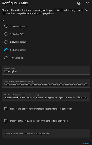

Tried hard, and found the solution.
After adding the “main” device into the Local Tuya, it asks if you want to add another entity. Realised I could add a “Select” type (instead of light):
That’s when I thought I could finally add the numbers shared before. But for mine, after using several times the “Query Properties” on Tuya Cloud, I’ve added:
# Valid Entries:
80000000000000000000000000000000;81000000000000000000000000000000;82000000000000000000000000000000;83000000000000000000000000000000;84000000000000000000000000000000;85000000000000000000000000000000;86000000000000000000000000000000;87000000000000000000000000000000;88000000000000000000000000000000;89000000000000000000000000000000;90000000000000000000000000000000;91000000000000000000000000000000;92000000000000000000000000000000;93000000000000000000000000000000;94000000000000000000000000000000;95000000000000000000000000000000;96000000000000000000000000000000;97000000000000000000000000000000;01000000000000000000000000000000
# Their respectives Friendly names (you can set whatever you want)
Screen: Weak;Screen: Normal;Screen: Strong;Music: Spectrum;Music: Electronic;Music: Listen;Scene: Rainbow;Scene: Fire;Scene: Read;Scene: Firework;Scene: Star;Scene: Drip;Scene: Particle;Scene: Flow;Scene: Ball;Scene: Swing;Scene: Breath;Scene: Pure;Solid
That did the trick, hope it helps someone. :slight_smile:
