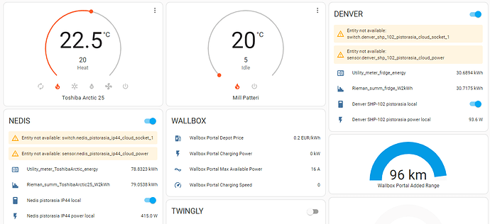

This is so frustrating to see both NEDIS and DENVER Tuya capable power plugs showing like this. Those “entity not available” are from cloud tuya. After few latest HA updates entities are gone. Well at least it shows power on and off status.
Those lower two entities are from local Tuya and after few minutes they are offline. What a waste of time and money.
