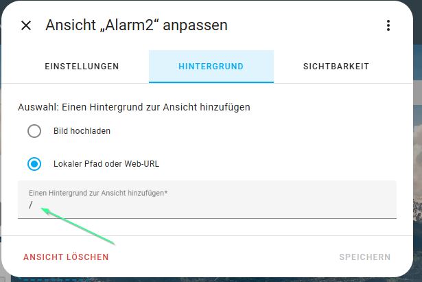

Has anyone actually got this working at the moment? I’ve been through all the instructions (with the updated forks too) and I can’t seem to get this running.
I used the forks too and I’ve installed the Mushroom cards. I put in a shlash here and the animated background works again.
