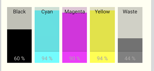

I had tried this:
         style: |-
          bar-card-value {
            color: white;
            text-shadow: 1px 1px #0005;
and
       - color: black
         entity: sensor.epson_ink_level_black
         style: >
           bar-card-value {text-shadow: 1px 1px white;}
but nothing is showing…isn’t the color styled? would probably be easiest?
secondly, while I am at the feature request department: :wink:
could the name be auto word-breaked? check Magenta and Yellow. In my post above the full friendly name is displayed nicely, so it should be possible?
Schermafbeelding 2020-04-06 om 14.42.52
#0005 is black so you probably want #FFF5. Also I’d like to keep the default text-overflow the way it is because it doesn’t look very nice otherwise in my opinion, but you can set the title CSS like this if you want to just break the title name:
bar-card-title {
  word-break: break-all;

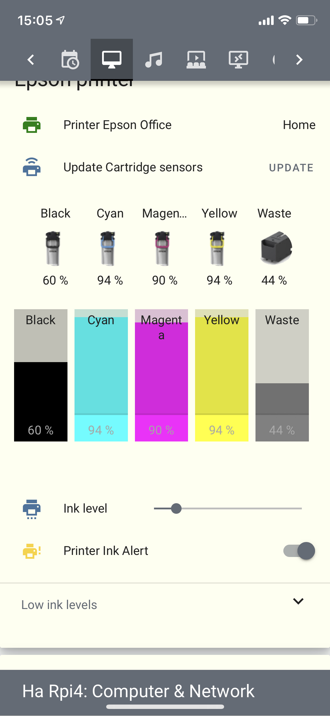

ok thanks will try that funny result ;-),
btw I tried the color on the individual sensor, but that isn’t supported I think? Now I try it on the card this is the result:
using:
  - type: custom:bar-card
    style: >
      bar-card-value {color:darkgrey;}
    stack: horizontal
    entity_row: true
    direction: up
       - color: black
       - color: 'cyan'
         entity: sensor.epson_ink_level_cyan
       - color: 'magenta'
         entity: sensor.epson_ink_level_magenta
       - color: 'yellow'
         entity: sensor.epson_ink_level_yellow
       - color: 'grey'
         entity: sensor.epson_ink_level_waste
its a bit of a hit and miss to find the right color to be contrasting to all cartridge colors…
so, if ever an indivual sensor style would be possible, Id certainly applaud that.
thanks for your quick support, much appreciated!

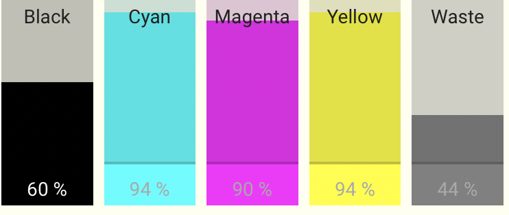

You can actually style each individual bar if you inspect the element in the DevTools and find the ID.
          #value_sensor_example_0 {
            color: #F00;
yes! I found it:
<bar-card-value id="value_sensor_epson_ink_level_black_0">60 %</bar-card-value>
but I cant get it to customize the color:
    style: |-
      bar-card-title {word-break: break-all;}
      #value_sensor_epson_ink_level_black_0: {color: white;}
(not are if the # is a typo or purposely there in your suggestion, but without it it doesn’t change either)
You’ve got a small typo there, need to remove the : . Also I’ll try to add some of these things to the documentation soon.
cool, and it works:
    style: |-
      bar-card-title {word-break:break-all;}
      #value_sensor_epson_ink_level_black_0 {color:var(--primary-background-color);}
thanks again.
