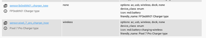

I’m trying to exclude devices that are charging. Is there a way to use the charging attribute/state to filter out some entities? Thanks!
Hi @biva ,
I am definitely not a pro. But I would go to “Developer tools” → state and filter entity for “charg”. I saw there entities which look like
you than can exclude the ones that are not charging similar like
type: custom:battery-state-card
secondary_info: "{last_changed}"
filter:
  include:
    - name: attributes.device_class
      value: battery
  exclude:
    - name: entity_id
      value: binary_sensor.*
I hope this helpled a little.
Juergen

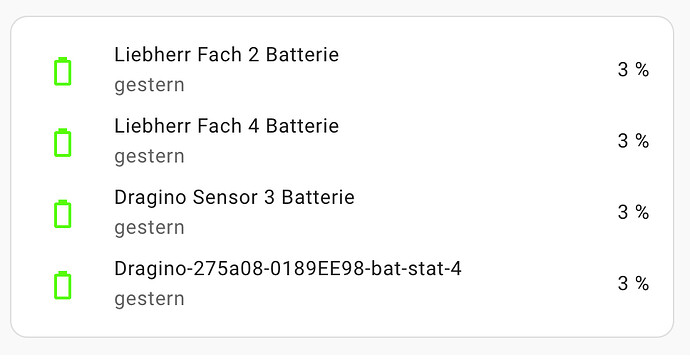

I have some Lorawan Sensors with very long battery live, and they only have battery status 0, 1, 2, 3. So my ideas was to multiply this value by 33, to get 0, 33, 66, 99 which would drop into more useful values but I do not understand how to use the multiply.
filter:
  include:
    - name: entity_id
      value: sensor.dragino*bat*
      options:
sort:
  by: state
collapse: 8
bulk_rename:
  - from: " Battery"
  - from: " level"
colors:
  steps:
    - value: 0
      color: "#ff0000"
    - value: 1
      color: "#ffff00"
    - value: 2
      color: "#00ff00"
  gradient: true
leads to
The values of the sensory are like e.g.
sensor.dragino_275a08_018905e3_bat_stat_2
can anyone enlighten me?
Many thanks
Juergen
HI,
this:
multiplier: 33
entities:
  - entity: sensor.dragino_275a08_018905e3_bat_stat_2
    name: Liebherr Fach 4
    multiplier: 33
  - entity: sensor.dragino_275a08_018905e4_bat_stat
    name: Liebherr Fach 2
    multiplier: 33
  - entity: sensor.dragino_275a08_018905e6_bat_stat_3
    multiplier: 33
  - entity: sensor.dragino_275a08_0189ee98_bat_stat_4
    multiplier: 33
sort:
  by: state
colors:
  steps:
    - value: 0
      color: "#ff0000"
    - value: 1
      color: "#ffff00"
    - value: 2
      color: "#00ff00"
  gradient: true
works as I hoped. Is it possible, that the multiplier only works on single entities? Which is not a real problem, as I only have thos “special” four, but if there is an easier way to use multiplier on more it would be great.
thanks
Juergen
