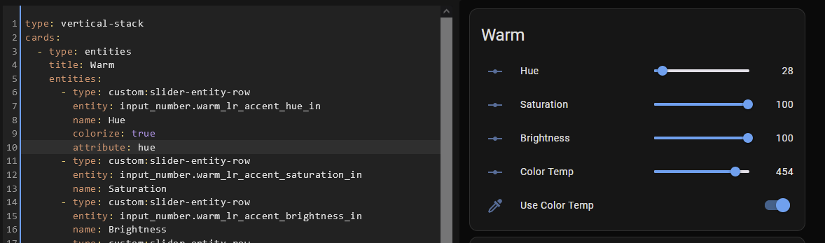

Hey everyone, sorry, I did not see Marius’ reply back in Jan, but did see Jays. I am posting below the full YAML in my dashboard that generates the following ENTITIES card. It contains both the rgb color slider AND the Temp color (cool - warm) slider. The post I was referring to is #18 in this thread, Nov 23, that begins with “OK, so it looks like”. In that YAML, the last line is there to be used as a replacement for the same line in the immediately prior code to get the Temp slider instead of the RGB slider. The other code is identical, as you will see in the complete YAML block I post here. So, Marius is correct that it was bad YAML, but I left a NOTE: explaining it just above the YAML.
Here’s what it looks like:
and here’s the code:

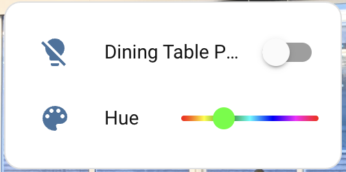

Updating this thread with code that works with the current versions of card-mod and HA (frontend 20260128.6). Gemini 3.1 was helpful in teaching me how this works, but that –ha-slider-thumb-color variable I had to dig out of the DOM inspector…
type: entities
entities:
  - entity: light.dining_table_pendant
  - type: custom:slider-entity-row
    entity: input_number.planets_hue
    hide_state: true
    card_mod:
      style: |
        ha-slider {
          --ha-slider-thumb-color: hsl({{ states('input_number.planets_hue') | int(0) }}, 100%, 50%) !important;
        ha-slider::part(track) {
          background: linear-gradient(to right, red, yellow, green, cyan, blue, magenta, red) !important;
        ha-slider::part(indicator) {
          background: transparent !important;
grid_options:
  columns: 6
  rows: auto
Thanks David! I’m going to give this a try!
EDIT: And it works perfectly! For my Color Temp slider, I replaced ::part background line above with my original color settings as below (my approximation), and it works as well.
