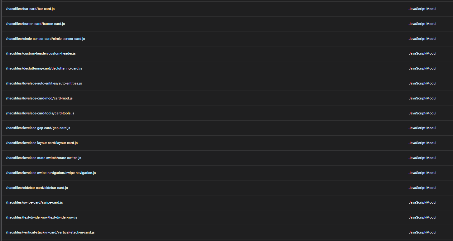

I added the resource over the new Lovelace Dashboard Panel (So no YAML)

I installed a few other resources
