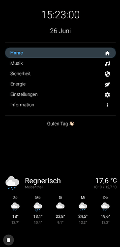

I have the same issues. Mostly bottomCard shows correctly. But at some time after refresh browser it doesn’t show again. When I refresh the view some times it comes back. The rest of sidebar Card works always fine.
What am I doing wrong? can someone help me?
bottomCard:
    type: vertical-stack
    cardOptions:
      cards:
        - type: weather-forecast
          style: |
            ha-card {
              background: transparent !important;
              color: #fff !important;
              overflow: hidden !important;
              box-shadow: none !important;
          entity: weather.openweathermap
          show_current: true
          tap_action:
            action: navigate
            navigation_path: /mushroom-tablet/weather-info
        - type: horizontal-stack
          cards:
              style: |
                ha-card {
              entity: sun.sun
              vertical: true
              primary_info: none
              secondary_info: none
              icon: >-
                {% set list = states | selectattr('entity_id','in',
                state_attr('group.garbage_collections','entity_id')) |
                selectattr('state','eq','1') | map(attribute='name') | list %}
                {% if list | length >= 1 %} mdi:delete-empty {% else %}
                mdi:delete {% endif %}
              icon_color: >-
                {% if list | length >= 1 %} red{% else %} white {% endif %}
              hold_action:
                action: none
              tap_action:
                action: navigate
                active: true
                icon: mdi:information-variant
                navigation_path: /mushroom-tablet/garbage-collection
                service_data:
                  transition: 5
                  entity_id: scene.idle
missed bottomCard
correct bottomCard
I was able to fix my problem myself with the following link … but I set it to 1second instead of 5seconds. It also work’s fine for me :slightly_smiling_face:
Just to note: that puts a lot of load on your browser. If you try to use this dashboard on a low power device, eg. a Pi Zero with an added display or an old Amazon Fire tablet, you’ll likely be running into problems, because the one second is to short to redraw the dashboard, and the next run has already been started.
But in most cases, like modern phones or computers, you won’t get in any trouble. :slight_smile: Just keep in mind, that you changed that value, so if problems come up, you know where to look. :slight_smile:
Nice style btw. :slight_smile:

        font-weight: bold;
        font-size: 22px !important;
        color: var(--main-theme-hex);
        padding-bottom: 0px !important;
        line-height: 20px;
        padding-top: 0px !important;
    .date {
        text-align: left;
        padding-top: 1px;
        font-weight: bold;
        line-height: 10px;
    .bottom {
        padding-top: 5px;
        padding-left: 5px;
        padding-bottom: 5px;
        padding-right: 5px;
    .sidebarMenu li {
        line-height: 70px !important;
  width:
    mobile: 0
    tablet: 7
    desktop: 7
  sidebarMenu:
    - action: navigate
      navigation_path: "/ui-lovelace-tablet/home"
#      name: ""
      active: true
      icon: mdi:home-account
    - action: navigate
      navigation_path: "/ui-lovelace-tablet/presence"
#      name: ""
      active: true
      icon: mdi:thermometer
    - action: navigate
      navigation_path: "/ui-lovelace-tablet/climate"
#      name: ""
      active: true
      icon: mdi:map-marker
    - action: navigate
      navigation_path: "/ui-lovelace-tablet/settings"
#      name: ""
      active: true
      icon: mdi:cog-outline
  bottomCard:
    type: custom:stack-in-card
    cardOptions:
      keep:
        box_shadow: false
        margin: true
        border_radius: true
        background: true
        outer_padding: true
      cards:
        - !include 'favourites_bar_vert.yaml'
    cardStyle: |
      :host {
        width: 95%;
        position: absolute;
        text-align: center;
        bottom: 5px;
        left: 5%;
      ha-card {
        background: transparent;
        color: #FFF;
        width: 100% !important;
