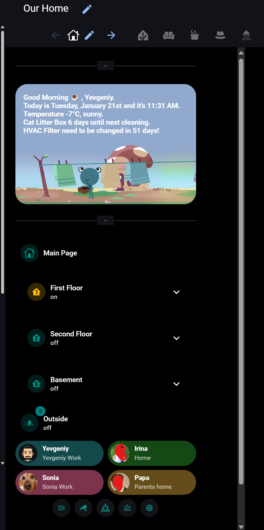

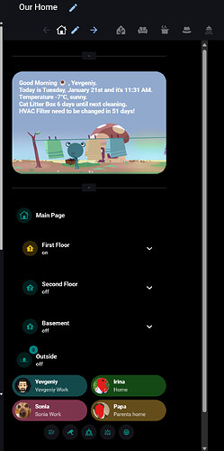

Today it looks like this. The menu is minimalistic.
Is there a possibility you can share your setup ?
Yes, please, share your configuration @hiddevanbrussel ! It’s awesome !!

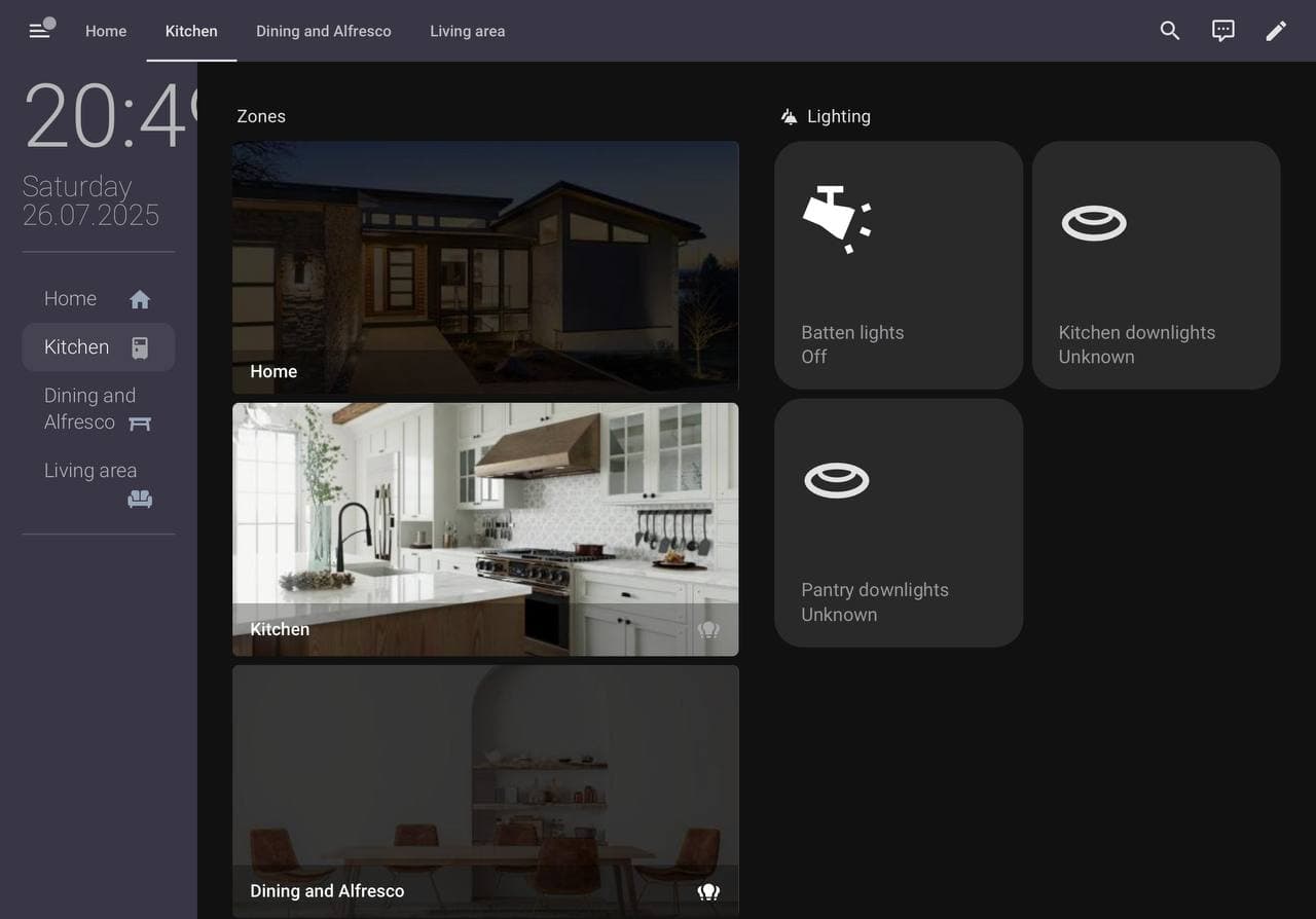

Hi, has the development been stopped here? Or is there a current alternative to Sidebar?
I’m tinkering with the sidebar card and it’s great!

Here is mine, and everything is working fine ( at least , I don’t see any problems with bottom card)
kiosk_mode:
  non_dmin_settings:
    kiosk: true
    ignore_entity_settings: true
  entity_settings:
    - entity:
        input_boolean.kiosk_mode: 'on'
      hide_header: true
      hide_menubutton: true
      hide_notifications: true
      hide_account: true
      hide_sidebar: true
    - entity:
        input_boolean.kiosk_mode: 'off'
      hide_header: false
      hide_menubutton: false
      hide_notifications: false
      hide_account: false
      hide_sidebar: false
sidebar:
  active: true
  bottomcard: true
  width:
    mobile: 0
    tablet: 25
    desktop: 25
  breakpoints:
    mobile: 768
    tablet: 1000
    desktop: 1024
  style: |
    :host {
        --sidebar-background: transparent !important;
        --sidebar-text-color: white;
        --face-color: #FFF;
        --face-border-color: #FFF;
        --clock-hands-color: #FFF;
        --clock-seconds-hand-color: #FF4B3E;
        --clock-middle-background: #FFF;
        --clock-middle-border: #000;
        --sidebar-icon-color: darkorange;
        --divider-color: white;
    .title h1{
        text-align: center;
        text-color: red;
    .sidebarMenu li.active {
     background-color: rgba(0, 0, 0, 0)!important;
     icon-size: 255px;
  digitalClock: false
  twelveHourVersion: true
  hideHassSidebar: false
  hideTopMenu: false
  date: false
  dateFormat: dddd DD MMM
  clock: false
  bottomCard:
    type: grid
    cardOptions:
      columns: 1
      square: false
      cards:
        - type: custom:text-divider-row
          text: '-'
          text-divider-color: transparent
        - type: custom:stack-in-card
          cards:
            - type: markdown
              tap_action:
                action: navigate
                navigation_path: weather
              card_mod:
                style:
                    ha-card {
                       background-color: rgba(0,0,0,0) !important;
                       box-shadow: none;
                       margin-left:0rem
                    ha-markdown-element:second-of-type h1 {
                        background-color: rgba(0,0,0,0);
                        color: var(--primary-text-color);
                        font-weight: normal;
                        font-size: 10px;
                        line-height: 3px;
              content: >
                ###{% if now().hour  < 5 %} Good Night {{'\U0001F634'}} {% elif
                now().hour < 12 %} Good Morning {{'\u2615\uFE0F'}} {% elif
                now().hour < 18 %} Good Afternoon  {{'\U0001F44B\U0001F3FB'}} {%
                else %} Good Evening {{'\U0001F44B\U0001F3FB'}}{% endif %} ,
                {{user}}.<br/>   Today is {{ now().strftime('%A') }}, {{
                now().strftime('%B') }} {% set suffix = ['st', 'nd', 'rd'] %}{%
                set day = now().day %}{% set index = 3 if day // 10 == 1 or day
                % 10 == 0 else (day % 10) - 1 %} {{ day~'th' if index > 2 else
                day~suffix[index] }} and it's {{ now().strftime('%-I:%M %p') }}.
                <br/>  Temperature
                {{states('sensor.openweathermap_temperature') | int  }}°C,
                {{states('sensor.openweathermap_condition') }}. <br/> Cat Litter
                Box {{ states ('sensor.litter_box_pad_days_left') }} days until
                next cleaning. <br/> HVAC Filter need to be changed in  {{
                states('sensor.hvac_filter_days_left') }} days!
            - type: picture
              image: /local/MyPictures/OIP-removebg-preview.png

                      tap_action:
                        action: navigate
                        navigation_path: artem-room
                      primary: Sonia Room
                      secondary: '{{ states(''light.sonia_s_bulbs'') }}'
                      icon: mdi:zodiac-leo
                      icon_color: >-
                        {%if is_state('light.sonia_s_bulbs', 'off') %} teal {%
                        else %}
                         amber {% endif %}
                      tap_action:
                        action: navigate
                        navigation_path: sonia-room
                - type: custom:expander-card
                  card_mod:
                    style: |
                      button.open {
                        background: teal !important;
                      button.close {
                  title-card:
                    type: custom:mushroom-template-card
                    primary: Basement
                    secondary: '{{ states(''light.basement_lights_all'') }}'
                    icon: mdi:home-floor-b
                    icon_color: >-
                      {%if is_state('light.basement_lights_all', 'off') %} teal
                      {% else %}  amber {% endif %}
                    card_mod:
                      style: >
                        ha-card {
                          background: none !important;
                        } ha-card:after { content: " {{ states.light |
                        selectattr('state', 'eq', 'on')
                          | rejectattr('name', 'search', 'Basement')
                          | map(attribute='entity_id') | map('area_name')
                          | select('in', ['Basement', 'Basement Restroom', 'Utility','Office'])
                          | list | count }}";
                          position: absolute;
                          display: flex;
                          justify-content: center;
                          align-items: center;
                          background: teal;
                          color: var(--card-background-color);
                          font-weight: bolder;
                          border-radius: 50% 50%;
                          top: -5px;
                          left: 40px;
                          width: 20px;
                          height: 20px;
                          font-size: 10px;
                  cards:
                      primary: Basement
                      secondary: '{{ states(''light.basement_lights'') }}'
                      icon: mdi:escalator-down
                      icon_color: >-
                        {%if is_state('light.basement_lights', 'off') %} teal {%
                        else %}
                         amber {% endif %}
                      tap_action:
                        action: navigate
                        navigation_path: basement-room
                      primary: Laundry
                      secondary: '{{ states(''light.laundry_vanity_light_light'') }}'
                      icon: mdi:washing-machine
                      icon_color: >-
                        {%if is_state('light.laundry_vanity_light_light', 'off')
                        %} teal {% else %}
                         amber {% endif %}
                      tap_action:
                        action: navigate
                        navigation_path: laundry-room
                      primary: Utility
                      secondary: '{{ states(''light.utility_room_light_light_2'') }}'
                      icon: mdi:water-boiler
                      icon_color: >-
                        {%if is_state('light.utility_room_light_light_2', 'off')
                        %} teal {% else %}
                         amber {% endif %}
                      tap_action:
                        action: navigate
                        navigation_path: utility-room
                      primary: Office
                      secondary: '{{ states(''light.office_light_switch_light'') }}'
                      icon: hue:room-office
                      icon_color: >-
                        {%if is_state('light.office_light_switch_light', 'off')
                        %} teal {% else %}
                         amber {% endif %}
                      tap_action:
                        action: navigate
                        navigation_path: office
              primary: Outside
              secondary: '{{ states(''light.outside_lights'') }}'
              tap_action:
                action: navigate
                navigation_path: outside
              icon: phu:outside
              icon_color: >-
                {%if is_state('light.outside_lights', 'off') %} teal {% else %}
                amber {% endif %}
              card_mod:
                style: |
                  ha-card {
                    box-shadow: none;
                    margin-left:0rem;
                    #width:15px !important;
                  ha-card:after {
                  content: " {{ states.light | selectattr('state', 'eq', 'on')
                    | rejectattr('name', 'search', 'Outside')
                    | select('in', ['Outside'])
                    | list | count }}";
                    position: absolute;
                    display: flex;
                    background: teal;
                    top: -5px;
                    left: 40px;
                    width: 20px;
                    height: 20px;
                    font-size: 10px;
            - type: horizontal-stack
              cards:
                - type: custom:bubble-card
                  card_type: button
                  entity: person.yevgeniy
                  button_type: state
                  show_state: true
                  styles: |-
                    .bubble-button-background {
                      background-color: ${
                        home: 'green',
                        'Church': 'antique white',
                        'Dacha': '#7fffd4',
                        'Дача': '#7fffd4',
                        'Artem House': '#0d98ba',
                        'Irina work': '#556b2f',
                        not_home: '#d2691e',
                        'Yevgeniy Work': 'teal',
                        'Parents home': '#b8860b',
                        'Sonia Home': '#e75480',
                        'Sonia Work': '#e75480',
                      }[state] ?? 'red'
                  card_type: button
                  entity: person.irina
                  button_type: state
                  show_state: true
                  styles: |-
                        home: 'green',
                        'Dacha': '#7fffd4',
                        'Дача': '#7fffd4',
                      }[state] ?? 'red'
              cards:
                  card_type: button
                  entity: device_tracker.life360_sonia
                  button_type: state
                  show_state: true
                  styles: |-
                        home: 'green',
                        'Dacha': '#7fffd4',
                        'Дача': '#7fffd4',
                      }[state] ?? 'red'
                  card_type: button
                  entity: device_tracker.life360_boris_bolembakh
                  button_type: state
                  show_state: true
                  styles: |-
                        home: 'green',
                        'Dacha': '#7fffd4',
                        'Дача': '#7fffd4',
                      }[state] ?? 'red'
            - type: custom:mushroom-chips-card
              chips:
                - type: action
                  icon_color: teal
                  tap_action:
                    action: perform-action
                    perform_action: input_boolean.toggle
                      entity_id: input_boolean.kiosk_mode
                  icon: mdi:menu-open
                  card_mod:
                    style: |
                      ha-card {
                        box-shadow: none;
                - type: action
                  icon_color: teal
                  tap_action:
                    action: navigate
                    navigation_path: camera-s
                  icon: mdi:cctv
                  card_mod:
                    style: |
                      ha-card {
                        box-shadow: none;
                - type: action
                  tap_action:
                    action: navigate
                    navigation_path: family
                  icon: mdi:family-tree
                  icon_color: teal
                  card_mod:
                    style: |
                      ha-card {
                        box-shadow: none;
                - type: action
                  tap_action:
                    action: navigate
                  icon: mdi:weather-hazy
                  icon_color: teal
                  card_mod:
                    style: |
                      ha-card {
                        box-shadow: none;
                - type: action
                  icon_color: teal
                  tap_action:
                    action: navigate
                    navigation_path: ha-info
                  icon: mdi:memory
                  card_mod:
                    style: |
                      ha-card {
                        box-shadow: none;
              alignment: center
        - type: custom:layout-break
