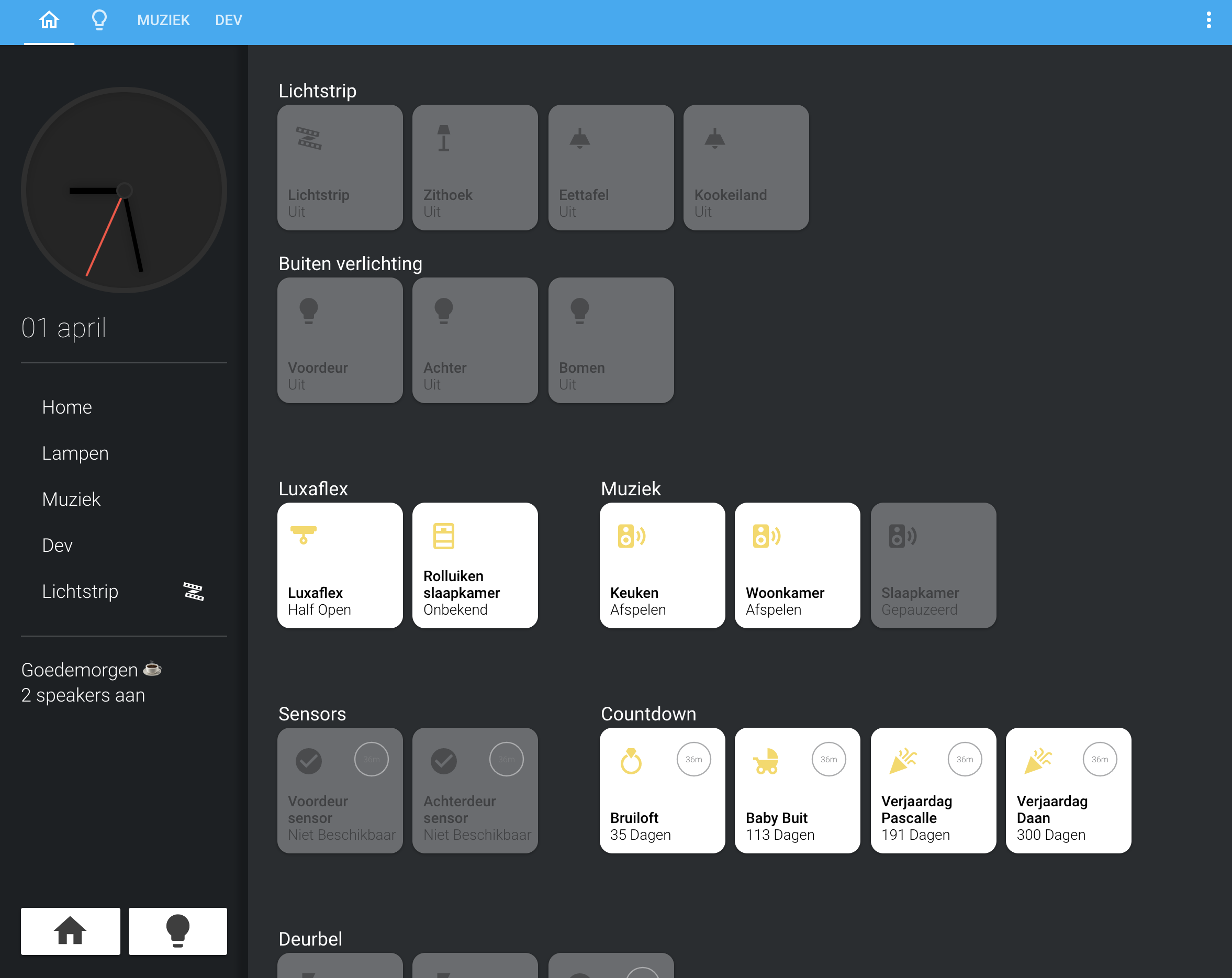

Just released new version with 2 changes:
date: true to your config to show current date and you can add dateFormat to set a format how the date should be shown.bottomCard you can see some config options on github https://github.com/DBuit/sidebar-card
Let me know if it works! below quick screenshot with some buttons on the bottom of the sidebar and the date under the clock.

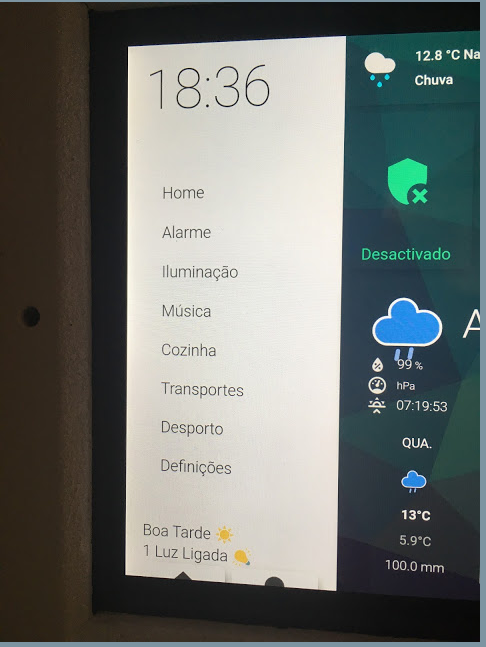

I’ve removed it and I can now see it…cut of slightly, is that something I need to change?
Desktop View
Tablet View
sidebar settings (if they are related)

Hi @dankitchen,
It is a problem with the card and different header heights. Gonna see of i van release a fix tomorrow!

I have the same problem … Stay out of the tablet screen.
