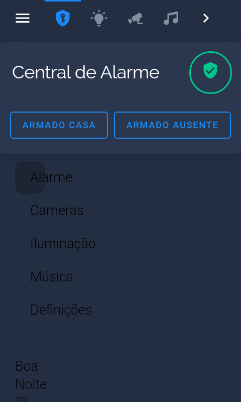

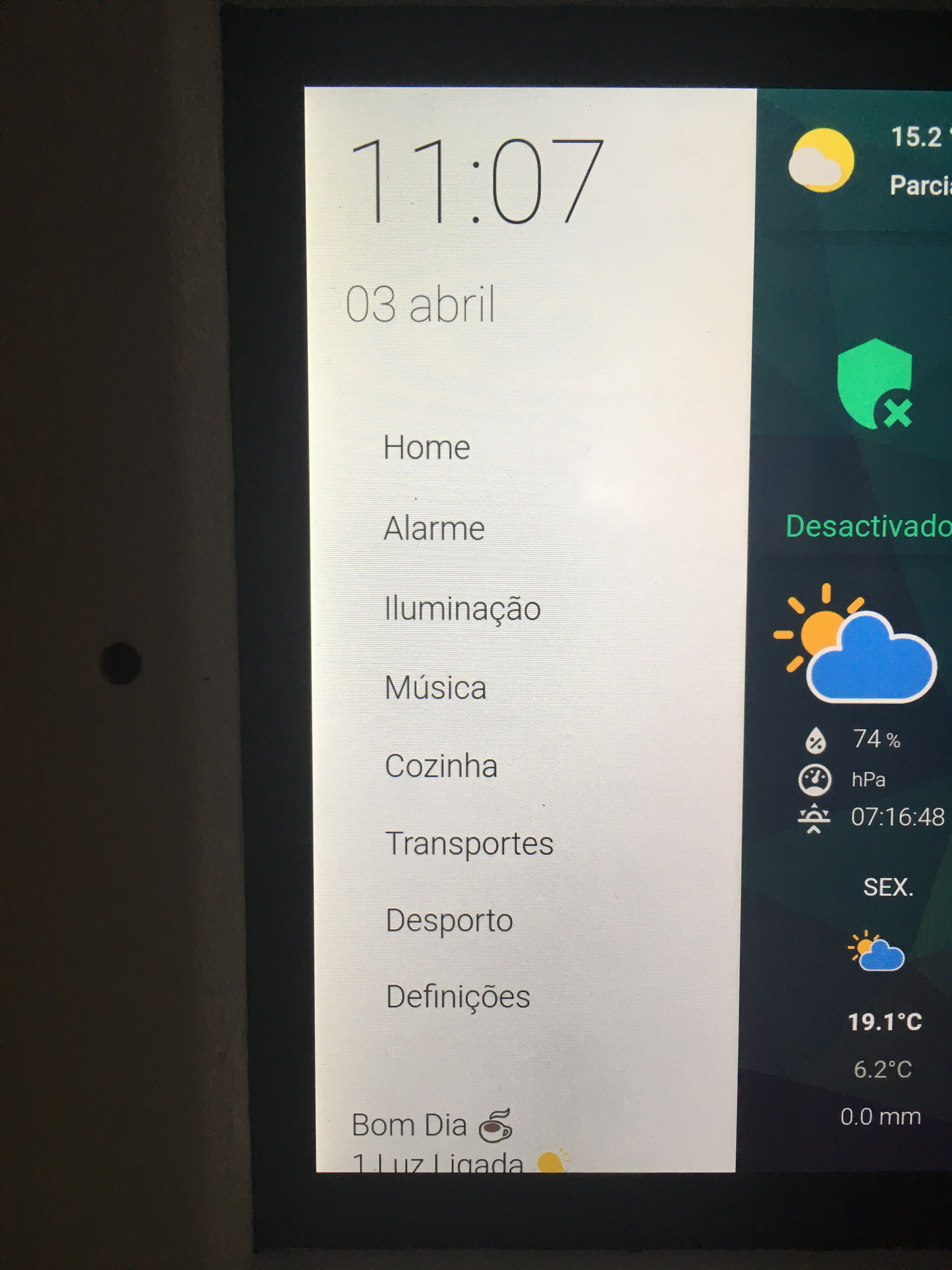

If I add “bottomCard” it does not appear correctly on the tablet screen. And if I add the “date: true” I don’t even see the “bottomcard”.
With “date:false” and bottoncard:
With “date:true” and bottoncard:
This does not work.
