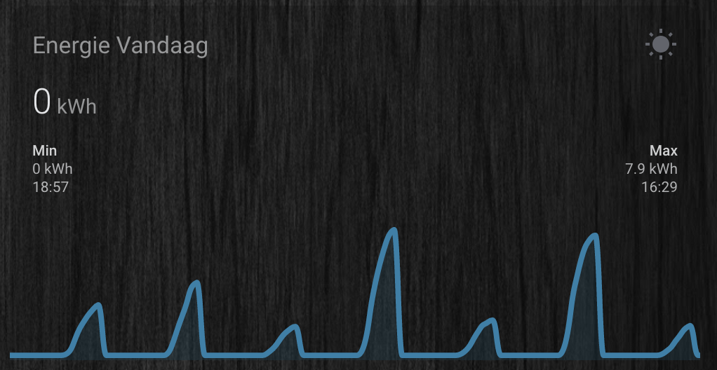

Hi @kalkih, many thanks for your amazing graph card.
I’m using it extensively.
There is however one graph that is not rendered correctly. I believe @Mariusthvdb also might have this issue.
This is the result when hovering over:
15
of below code:
  - type: custom:card-modder
    style:
      background-image: url("/local/custom-lovelace/cardbackK.png")
      background-repeat: no-repeat
      background-size: 100% 100%
      border-radius: 12px
    card:
      type: custom:mini-graph-card
      entities: sensor.solar_energievandaag
      font_size: 75
      hours_to_show: 168
      labels: true
      line_color: '#2581ab'
      line_width: 2
      location_state: center
      more_info: false
      show:
        extrema: true
Any idea what might be wrong?

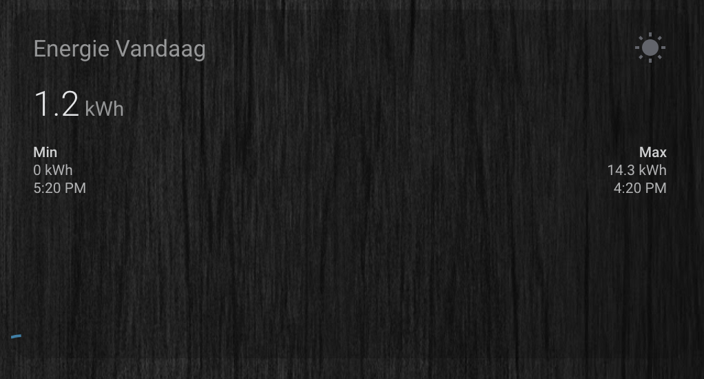

Hmmm
no idea at all actually. Is it just that one graph that is affected by the issue? Any errors in the browser dev console?
Just that one graph indeed. I can’t see errors in the dev console.
Could it be that, because it displays solar panel energy, there are no values for some time (sun down)?
Okay, possibly, but if the history contains “gaps” the graph would just render a horizontal line until the next available history entry.
I can’t recreate this so if you could do me a favor (if possible) and grab the sensor history and send it my way so I can debug this issue.
You can fetch the history manually by running the following bash script.
curl -X GET -H "Authorization: Bearer LONGLIVED_TOKEN” \
       -H "Content-Type: application/json" \
       http://localhost:8123/api/history/period/2019-02-02T00:00:00+02:00?end_time=2019-02-09T00%3A00%3A00%2B02%3A00&filter_entity_id=sensor.solar_energievandaag
You’ll need to create a long lived token in HA and replace “LONGLIVED_TOKEN” in the snippet above with the one you’ve generated. Then replace localhost/port to match your HA setup.
I just tested it again and does seem to work, not sure what happened yesterday. Just reporting here that it does work.

I wasn’t succesfull with curl command (kept getting errors, not so familiar with it), so I tried to get some data with the help of grafana. Pleae see below.
By the way, in the mean time I see a small blue stripe popping up:

Ok, great, I actually also tried to recreate the issue yesterday, but wasn’t able to.
Let me know if it comes back.
Alright, thanks for the data, I guess the second column is the sensors state? The states reported as “-” could possibly be causing issues when computing te graph.
Can you confirm that the sensor sometimes reports the state “-”, I guess when it’s idle?
Also, is this a template sensor?
The “-” are I suppose NULL values from the template sensor when there is no reply from the solarpanel converter.
Pls find below the template sensor config:
  - platform: command_line
    command: 'curl "http://xxx.xxx.x.xx/real_time_data.xml" 2>&1 | grep -E -m1 -o "<e-today>(.*)</e-today>" | sed -e "s,.*<e-today>\([^<]*\)</e-today>.*,\1,g"'
    unit_of_measurement: "kWh"
    scan_interval: 3600
Perhaps I should default it to zero when there is no response?
Ok, I see.
Yes if you’d change it out to zeros it would most likely work, would be great id you could try.

Fixed!
Used a MySQL client to fill the NULL values with 0.0.
Now to get the template sensor to prevent the NULL values
 :wink:
Thanks for your help and the amazing card!
