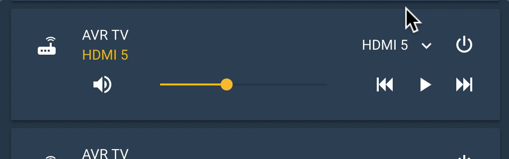

Great work in this one! I´ve been wanting a slick simple media player with volume control without entering more-info screen for quite some time now. The only thing I´m missing is the source selection. Would it be possible to add a small input select to the left of the volume settings or under it like the tts option? Preferably it will show and change the option automatically when source is changed but also clickable.
Either way, great work!

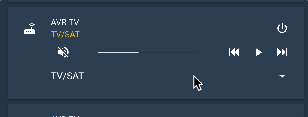

Hmm, I will add that as an option in the next release. What do you think of something similar to the input select dropdown in the more info dialog?
Unfortunately I don’t think it would be possible to add it to the left of the volume, the space there is just too small. Maybe below, like the tts input. what do you think?
Cool! I would like to keep it as minimal as possible thats why I thought to have it next to the left of the volume control. If its not doable I guess it could be added under like tts. But lets say you want to have both tts and input selection. It will make the player rather big.
Would it be possible to have the part of “now playing” (yellow in your screen shots) clickable to pop a dropdown input select?

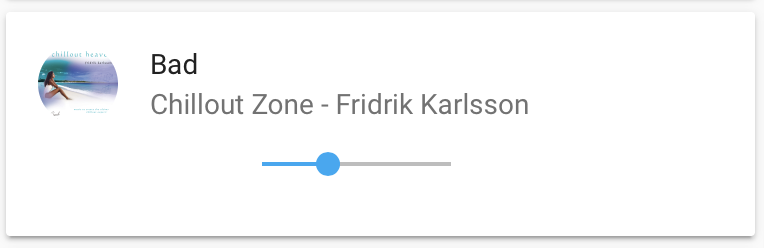

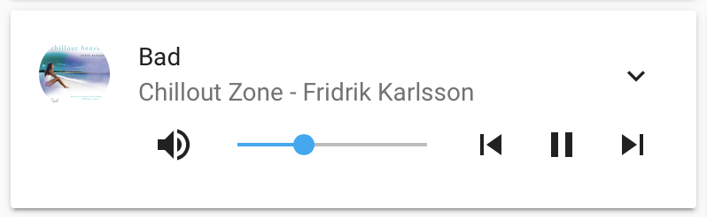

Is is possible to also make it work on a white background instead of the midnight theme? Right now the source, play, next, previous button are hidden in white on white.
Edit: For some reason, the controls show up on a white background and sometimes not. I have not yet figured out what causes this.

That is strange, the icons and most of the text (except with artwork: cover) is set by the theme variables.
To be more specific below are some of the different variables some elements use:.
  • Name, source: var(–primary-text-color)
  • media-info: var(–secondary-text-color)
  • buttons: var(–iron-icon-fill-color) and var(–paper-item-icon-color)
The only white theme I’ve tried is the default theme though (below).
It would be great if you could send me your theme, so I can check for issue/issues.
Thanks Kalle, the theme is the standard theme that comes with HA.
It happens on two machines, on different browsers. Clearing the cache did not make a difference.
Ok, I’ll try to specifically set the color variables for all elements, currently some elements are relying on them being set by default, but that does not work as expected in browsers/cases it seems.
Ok, so I’ve made some changes, and It would be great if you could try this version.
Don’t forget to change your card reference in ui-lovelace.yaml and add something like ?ver=0.8-beta at the end. Alternatively clear the browser cache
I run it with both default and custom theme but never seen the icons disappear.
