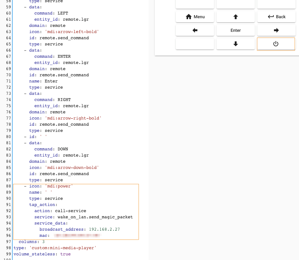

@kalkih As a big fan of your great plugins I was helping my son with his ‘remote control’ for his LG TV (webostv) using your Mini Media Player card. I noticed the support of tap_action to start a service. So I created a button to start a service to turn on his tv with a WOL packet (replaced the real mac address with a fake one):
    - icon: 'mdi:power'
      type: service
      tap_action:
        action: call-service
        service: wake_on_lan.send_magic_packet
        service_data:
          broadcast_address: 192.168.2.27
          mac: 'aa:bb:cc:dd:ee:ff'
But something is (done) wrong, because i get this error:
2020-04-07 14:31:46 ERROR (MainThread) [frontend.js.latest.202003181] https://xxxxxx.duckdns.org:8123/hacsfiles/mini-media-player/mini-media-player-bundle.js:1:73711 Uncaught TypeError: Cannot read property ‘split’ of undefined
Using dev tools to start the service wake_on_lan.send_magic_packet with service data as below works!
mac: ‘aa:bb:cc:dd:ee:ff’
Someone any clue?
No, try the custom spotify card
No, the shortcut list shouldn’t get cutoff though, there’s an issue open on github regarding this, and while I can try to make it work with most cards it also depends on the card you nest it inside, if it doesn’t allow overflow I can’t really do anything on my end.
tap_action is not a valid option for a shortcut object, here are some shortcut examples.
Try this, this should work.
- icon: 'mdi:power'
  type: service
@kalkih You’re the best!! Thanks!!

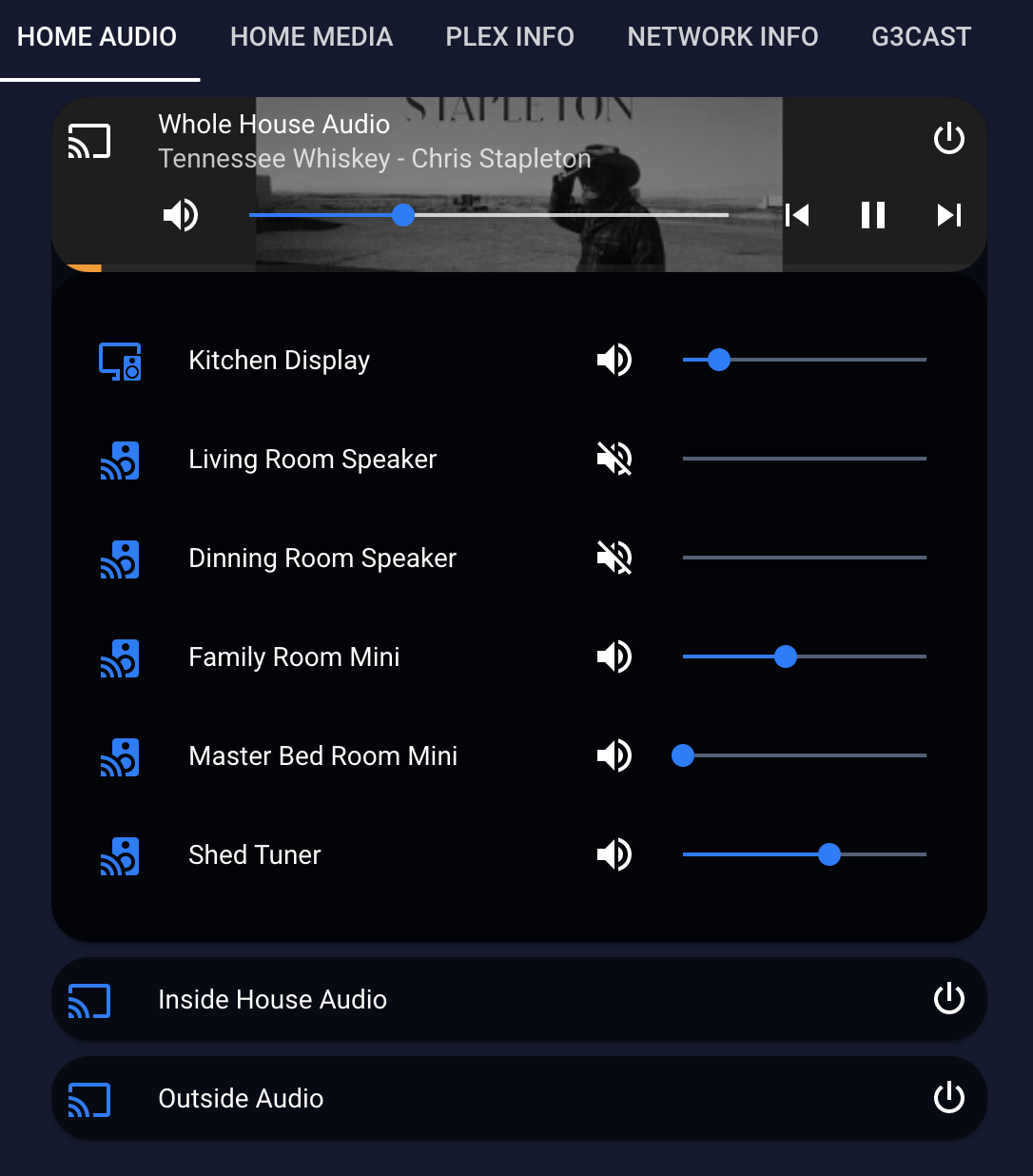

Okay, I have been messing with this for months on my own and can not find a resolution. I even have asked my friend Mr google 1001 different ways and he has not helped…
I am not 100% sure what my limitations would be so I have a couple of questions.
Is there a way to make it so if a “Google Speaker Group” is not playing to Hide the associated speakers?
So here the group is ‘Inside House Audio’ lets call it iHA.
I also have one for ‘Whole House Audio’ we will call it wHA.
wHA use all the same speakers but has 1 addon my ‘Shed Tuner’

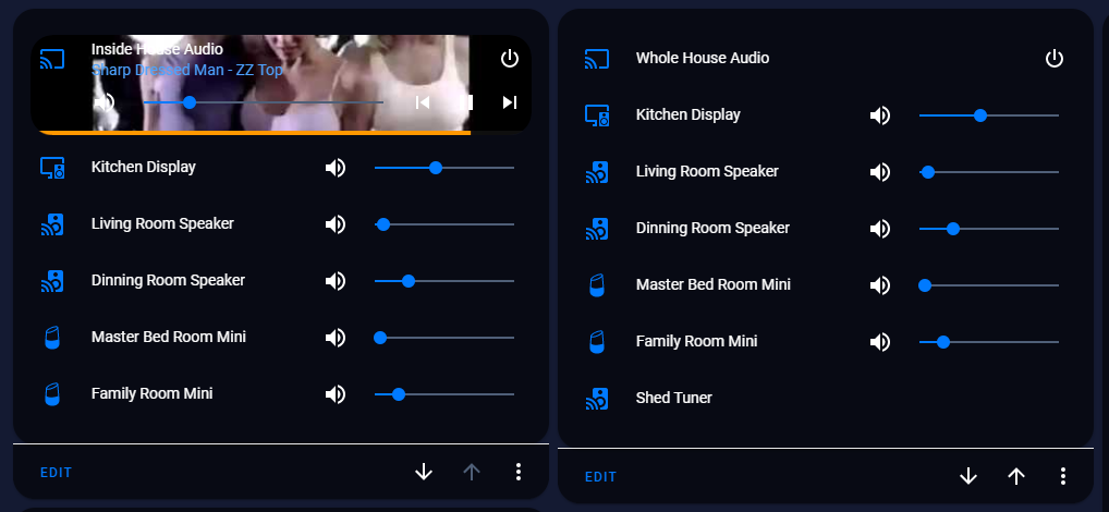

Now for this card when the iHA is NOT playing it would be nice to hide all the speakers.
In this instance this is what I see when iHA is playing. It would be nice and clean looking if the speakers under wHA would be hidden as it is not being used currently…

Wrap the individual speakers speakers in a vertical-stack inside a conditional card and base the condition on the speaker group entity state.
Thank you, I was trying to do conditions but as I am pretty new to this I was not able to get them to work. Would you be able to show me how it would work? I know… Its kinda like asking you to do my homework for me but its driving me CRAZY!
I would propose something like this
- type: custom:mini-media-player
  entity: media_player.speaker_group
- type: conditional
  conditions:
    - entity: media_player.speaker_group
      state_not: 'off'
      state_not: 'unavailable'
  card:
    type: entities
    entities:
        entity: media_player.group_speaker_1
        group: true
        entity: media_player.group_speaker_2
        group: true
        entity: media_player.group_speaker_3
        group: true
If you want everything inside “the same card” you could wrap everything inside a vertical-stack-in-card or similar and then use a vertical-stack inside the conditional card instead of the entities card.
Thank you very much! I am so new to code and does not help that all my code is MUTCode.

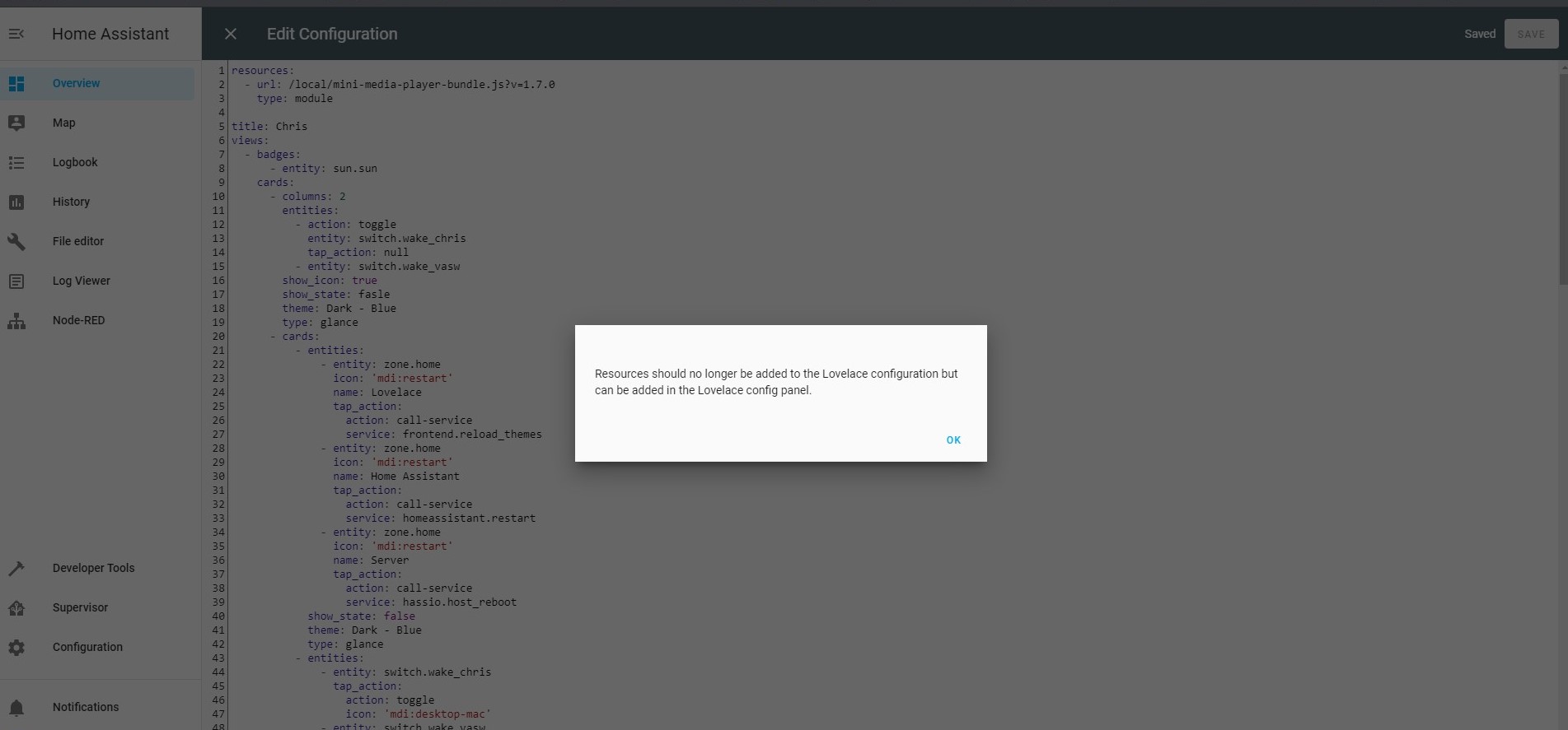

Hi i installed
Im trying to put the custom option on my card:
entity: media_player.fire_tv
And i get that error : Error: Custom element not found: mini-media-player
I already paste the mini-media-player-bundle.js on home assistant\homeassistant\www directory
and paste the
resources:
  • url: /local/mini-media-player-bundle.js?v=1.7.0
    type: module
on the ui-lovelace.yaml must do something else to recognize the custom media ?
Resources should be added in your configuration.yaml now instead of in ui-lovelace.yaml.
And if you’re using the GUI go to Configuration, then Lovelace dashboard, and there should be add resources or something similar I believe.
I tried to paste that on the UI config and now i get that error(see the picture)
Do as it says in the popup and you should be fine.

I figured in the spirit of community, I would share my config. I am sure there are many like it, but this one is mine…
Shortfalls:
  • Unable to enable ‘back’ and ‘skip’ controls
  • Can not directly start casting from youtube music from Hassio
Please let me know if you have any suggestions that would correct, optimize or add functionality I am very new to .yaml and Hassio.
Stream Service:
  • youtube music
Hardware:
  • google display
  • google mini x 2
  • google audio casts x 3. (Awesome devices, that seem to be EOL as they were very under-appreciated)
    • Dining / Living Room, each paired with an ‘Anker Soundcore 2’
    • Shed, is paired with a Sony AV tuner
While nothing is playing:
After saying, 'hey google, play music whole house audio":
My working code:
(I do not understand why HA screws up all YAML code formatting after a reboot…)
