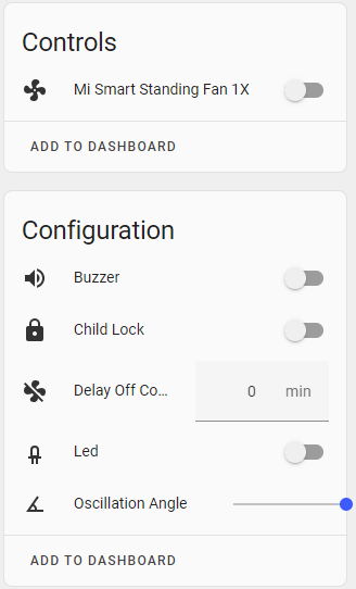

Some minor customization on the chip, my YAML:
type: 'custom:button-card'
template:
- chip_mdi_icon_state
- custom_fan_timer
variables:
ulm_chip_mdi_icon_state_icon: mdi:fan
ulm_chip_mdi_icon_state_entity: fan.mi_smart_standing_fan_1x
ulm_chip_mdi_icon_state_fan_timer_entity: number.mi_smart_standing_fan_1x_delay_off_countdown
and the customization in a separate YAML file:
custom_fan_timer:
icon: |
var fan_timer_icon = "mdi:fan";
if (states[variables.ulm_chip_mdi_icon_state_fan_timer_entity].state > 0){
var fan_timer_icon = "mdi:fan-clock";
return fan_timer_icon;
label: |
var fan_timer_label = states[variables.ulm_chip_mdi_icon_state_fan_timer_entity].state;
var hours = ~~(fan_timer_label / 60);
var minutes = fan_timer_label % 60;
if (fan_timer_label == 0){
return "";
} else if (minutes < 10){
return hours + ":0" + minutes;
} else {
return hours + ":" + minutes;
How did you get the remaining value of the timer in that number entity ?
