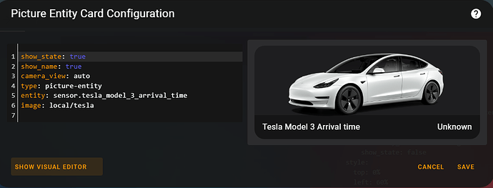

I dont fully understand how you made this. I have been trying to get this to work for a few days and I am drawing a blank. I have to comment out the label just to get a the name to display and the image. have you had to make any adjustments since you created it?

What is the error message in the dashboard? But yeah there is no custom template in that one, i also just copied most of the parts, you can see it in my initial post, it was also just a reply.
And no there was only one small modification from my side, where i added a new script at the end of the card.
The only error what i can see on your side is that you don’t have a png or jpg in the “entity_picture” - can you also please check if the entities from your Tesla are really named like you mentioned it. Because with the release from version 3.x of the Custom Tesla Integration many sensors were renamed. Also a complete reinstallation of the custom component was suggested.
See here Release v3.0.0 · alandtse/tesla · GitHub - most of your sensors still seems to be in the old naming format
Yeah i’m able to display the car with just local/tesla - does it require it to be .jpeg or png?
yeah I make sure i went to developer tools and checked that every entity was correct before applying it to the code. I cant screenshot hte entire error but this is the main one.
Mhm seems that some templates changed since my first point. I updated them already in my file.

@Freshhat yep!! that fixed everything thanks alot for your help
