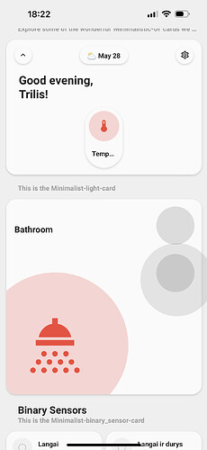

I am having trouble with my background image on my iOS mobile app since an update of Home Assistant / Minimalist UI. The background image does not stretch over the full length of the different views. This is only the case for the theme ‘minimalist-mobile’, which is the one I prefer since it hides the top / bottom tapbar.
I use the code below in my ui-lovelace.yaml. Does anyone know what I should change in order for it to work again?

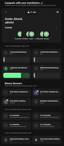

So I have now tried to set the UI lovelace minimalist up several time and followed the instructions. Everything works fine as it seems, but I don’t get the scene to look right!!! What did I miss? What’s my mistake … I cannot figure it out
