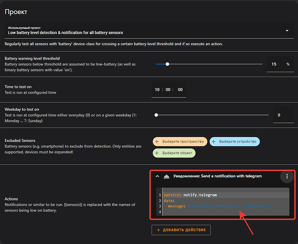

Hello. Please tell me what needs to be changed so that messages come with the name of the sensor. For example, the name of the sensor: the temperature outside, and in the message indicates its battery number in the form: Battery158d000208d258 (3 %)
it is all shown at the top
in your message area put
{{sensors}}
this will return the name
you can also do this in message
The battery of the sensor(s) {{sensors}} is low
That is the name of your device. See my arrow… that is your sensor.
First click on your sensor, see my one.
A pop up window will appear, then click on the settings tab. Then see the name. Look at your one and change to what you would like.

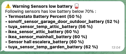

Hey everyone, I made a small tweaks on the excellent blueprint from @Sbyx, basically sort the entities so you can see in a glance which are the lowest battery levels and also show result as a list, instead of a comma separated values.
I don’t know how to share with the community or even if this is posible, if this is not the right place, please let me know.
Preview of result on Telegram:

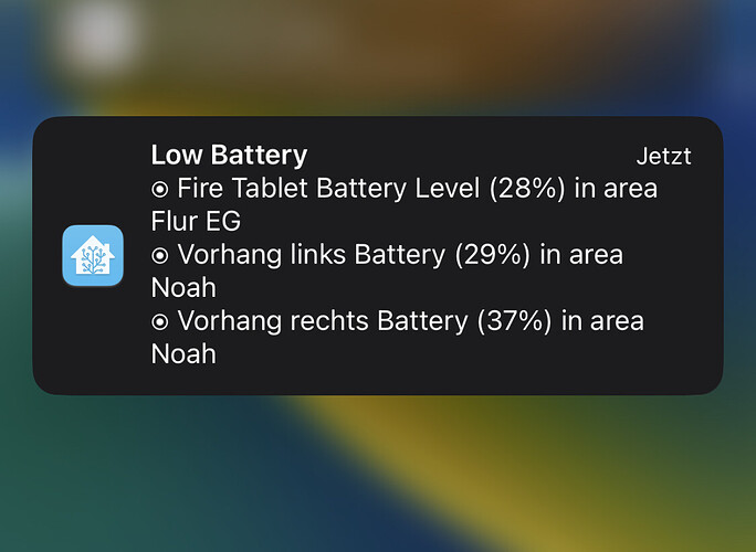

Hey everyone and a happy new year! I made some more tweaks on @garanda21 work and wanted to share this with you. Most significant highlights are the weekday selection. a fully customizeable message for the detected low battery sensor and a sorting option. A picture says more than words. So here we go:

The message on my iPhone looks like this:
