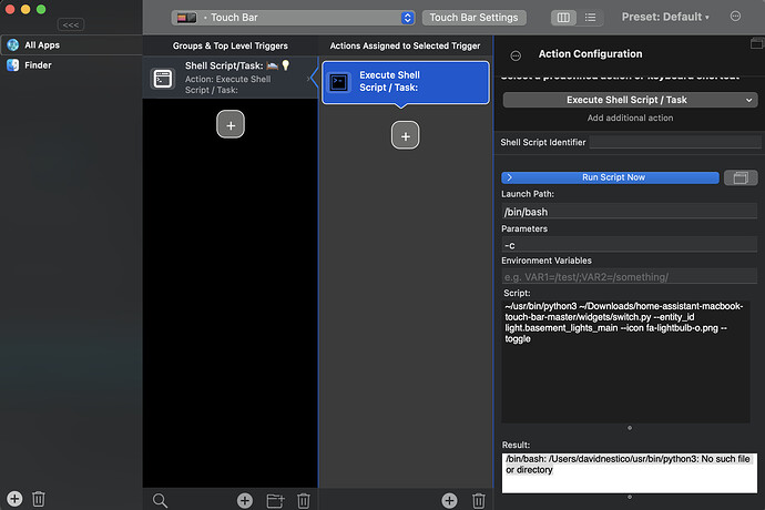

Can you please help me? When I run it I get this error:
/bin/bash: /Users/davidnestico/usr/bin/python3: No such file or directory
It appears I have the default “python3” installed because “which python” in terminal shows nothing, but “which python3” does show a file path.
Another thing is I have no idea how to do the light slider, no idea where the code has to go.
It’s probably super simple I just can’t figure it out right now.
