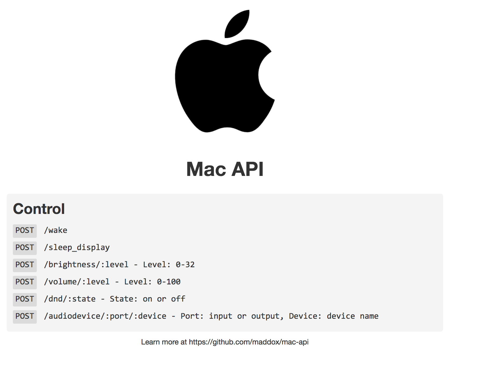

OK found it, but need to figure out how to configure it.!
OK, so it is an API for controlling the Mac. Still useful, but not what I need.
