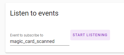

In the docs I see “token” is preferred over of “password”. Maybe “password” doesn’t work anymore with latest HA. MagicCards docs is from feb 2019, so a lot has changed on HA side. You can create a Long-Lived Access Token on the profile page. I have configured it using a token.
I’m not sure I understand what I need to do for Home Assistant side of things? I know I will have to create an automation but do I need to create an entity or install a plugin or even add to the config.yaml?
On the HA side you only need to capture the event magic_card_scanned.
See Dev Tools > Events
