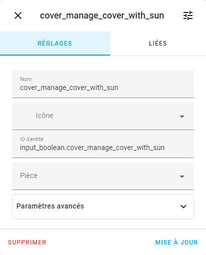

Hello
I don’t know why it doesn’t work. If someone can help. It closes well but never open after
Capture d’écran 2022-06-13 à 16.28.22|690x365

Hi there!
I’m trying to implement the template in my HA, it doesn’t work and I get an error with the var configuration.
I installed the variables integration, is there anything I need to do in my config.yaml afterwords?

Hey there,
Yes, I’ve added the following line in my config.yaml file
var:
And I have the boolean here:
I’m really confused… ![]()
Hello @Ivydree
Yes, I now, the use of variable was not clear. I have updated the Prerequisites
You will have to add fallowing lines to configuration.yaml
var:
cover_NAME_OF_YOUR_COVER: #Replace NAME_OF_YOUR_COVER with the entity_id without cover. for exemple my entity_id is cover.bureau, the variable will be cover_bureau
friendly_name: "NAME YOU WOULD LIKE TO USE"
initial_value: 0
icon: mdi:bug

Thanks! I’ve added the variable now, however it doesn’t work still… I’m probably missing something somewhere, is there anything I can post here so you can point me in the right direction?
Hi there!
Still no luck with this blueprint… I must be missing something.
But nothing happens!
I’m confused, can someone help?
