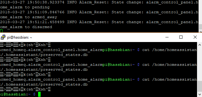

Hmmm, not quite working for me. I see this when I change the alarm:
INFO Alarm_Reset: State change: alarm_control_panel.home_alarm to armed_home
But on reboot, i get:
INFO Alarm_Reset: Adding alarm_control_panel.home_alarm, setting value to current state (disarmed)
Doesn’t seem to be writing to my DB file, tried changing ownership/permissions and no luck.

Strange. If you cat the DB file after a state change you should see the latest state at the end of the cat output.
Interesting, working now.
One important thing I found out is that you should close and open the database after each “save” operation. If it’s not saved and there’s a power outage you’ll lose the saved state.
Shelve doesn’t save to the file after every operation? It must do, as my file changes whenever the state does.
Hmmm…yeah it’s not picking up all the changes, only some.
Hmm that’s odd?
Yeah not picking up at all. File isn’t modifying either.
Must be a permissions thing then?
File is owned by homeassistant user and i just tried it as 777, still no luck.
Tried deleting the file and restarting. Stumped. It writes some gibberish to the file but no alarm state.
Yeah I think the gibberish is just the shelve db meta data or something. Normally the state stuff is in plaintext at the end of the gibberish. I’ll have a look at mine when I get home to see if there’s anything about how I’ve set it up.
Not under all circumstances. I found out when killing appdaemon in testing that it doesn’t flush the saved data to the file immediately.
Ok will have to look at how to close, and move the open into the set_alarm routine.
Mine’s gibberish but with this at the end:
alarm_control_panel.ha_alarm▒Xpendingq.alarm_control_panel.ha_alarm▒disarmedq.alarm_control_panel.ha_alarm▒X
I run appdaemon in a docker container and my db file is owned by root with 644 perms.
