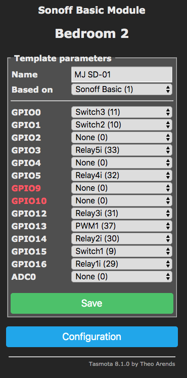

Is it possible to use this dimmer with Tasmota? I don’t see a template or a module for either. Successfully managed to get it flashed and working with MQTT.
However, I’ve already bricked 1 of the 5 trying to go down the ESPHome route and would prefer to just stick with Tasmota before I fry another. Really frustrated with myself at the moment. Any guidance would be greatly appreciated.
Yes. http://www.thesmarthomehookup.com/dimmers/sold-as-martin-jerry/
That’s awesome @markm. Thank you.
Unfortunately, it still didn’t make any difference though. I entered the values and the console commands specified exactly as written and the dimmer still doesn’t turn the light on.

Mine:
Smart Home Hookup:
Very odd. Perhaps try setting the Based On to Generic (18) instead of Sonoff Basic?
I know the settings I linked do work, as I was using those with Tasmota before switching to esphome (a while ago on older Tasmota release).
Also, sometimes when switching between Tasmota and esphome, I had to reset the switch (push small button under the switch paddle or cycle the breaker at the box). May want to try that if you haven’t already.
I’m also curious about esphome bricking one of your devices. What version of esphome are you using?
Thanks for the suggestions @markm. Unfortunately, nothing worked.
I was however able to flash the switch that I thought I’d bricked and the remainder with esphome and all is well now. :slight_smile:
