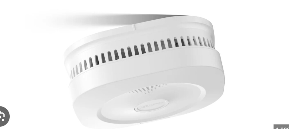

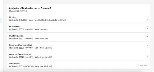

My new Smoke CO, the MS1 from Sensereo also has the Binding cluster. I wonder if it’s possible to link with a lamp or even a Siren (when it exists).
Do you guys think it’s possible to test it using this script too?
The next thing to check is what clusters are supported as client since that determines the functionality when bound. According to the Matter compliance document, only the OnOff cluster.
<feature>Does the device implement the on/off cluster as a server?</feature>
<support>false</support>
<feature>Does the device implement the on/off cluster as a client?</feature>
<support>true</support>
That means it can turn on or off something when bound, the behaviour will depend on how it’s implemented though but I guess we can assume it turns it on when smoke is detected.
Since a light implements the OnOff cluster too you can certainly test binding the sensor to a light, it won’t be any different than the examples here binding a light switch to a light.
