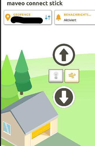

the button in the app only shows up if the lower intermediate position is set in the marantec drive. The default set position from my garage manufacturer for the ventilation position was the upper position.
