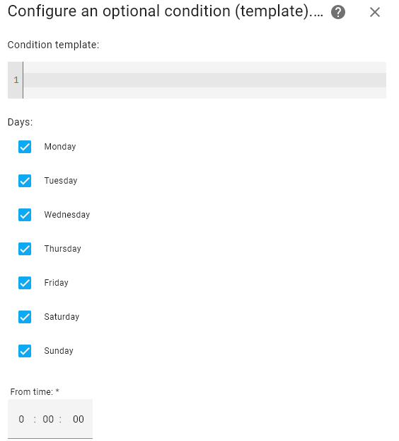

Unfortunately I can’t figure out where to edit the existing template. Please have a look at the screenshots below.
Edit the main configuration shows the template as empty:
Edit a sensor configuration adding the value template leads to an “unknown error”
Seems like a bug. I’ll need to dive into the unknown error…
