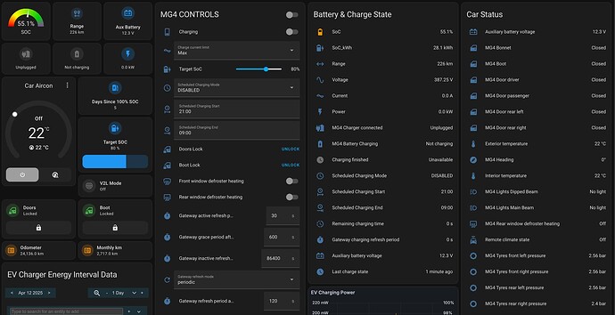

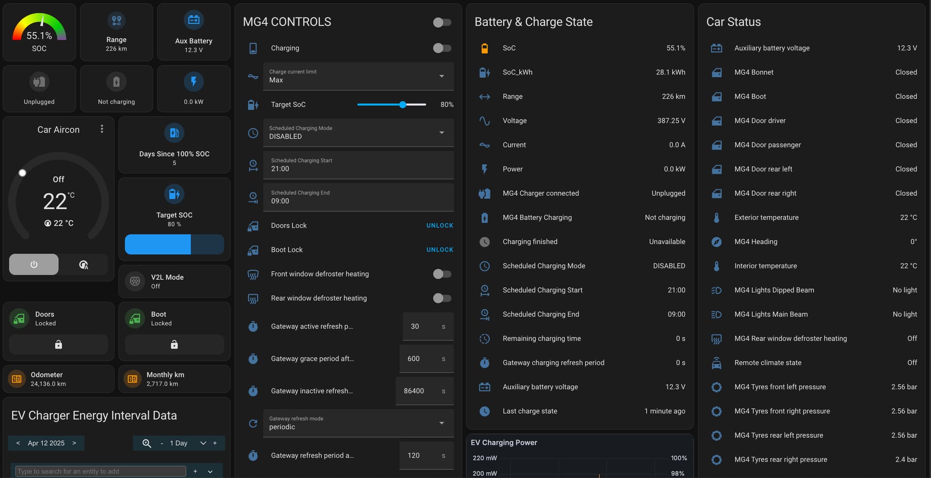

Yes, they are all the same settings as for the legacy version.
And it looks like that was the problem. I do not know how, but the MQTT broker password was changed in the legacy SAIC addon settings. Which would explain why it stopped working.
Thanks for pointing me in that direction. I’m back online:
