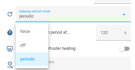

I think it is the Gateway ineractive refresh period.
Screenshot 2024-01-08 223610
You can choose either periodic of forced refresh. And ofcourse off… but it is nice to have some refreshed data :slight_smile:
