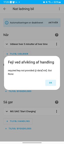

Hello again download the new version, and tried to set up an automation, to charge car. I ran it and got
Im new to this, do i need to put in the VIN for my car ?
Where and how? Please.
For that you have to use the VIN of the car on the service/action. Bear in mind that you may have more then one car on the same HA instance, so you need to specify the VIN.
Your automation “Action” should look something like this:
Hope it helps

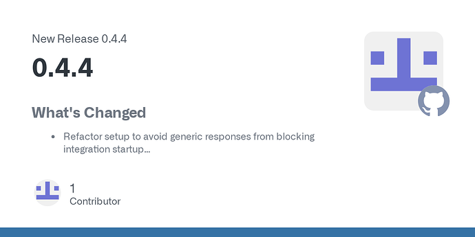

Hi everyone,
Latest updates to the integration on release 0.4.4
WHAT’S NEW SINCE 0.4.1
0.4.4
  • Refactor setup to avoid generic responses from blocking integration startup
  • Revise Generic Response verification method
  • Revise Charging Gun State sensor mechanics for BEV and PHEV only.
  • Additional Debug Logging for Generic Responses
0.4.3
  • Revise Generic Response verification method to discard responses with SOC over 100%
0.4.2
  • Revise Vehicle Type mechanics. Avoid overriding user selection from configuration process
  • Revise SOC sensor data retrieval. Now main data will be obtained from Charging Data and fallback on Basis Status.
  • Revise sensors available for BEV, PHEV and HEV.
  • Refactor data updates on initial setup and update intervals
  • Refactor data calculations for Charging Current and Charging Voltage sensors
  • Add Charging Power (kW) sensor
  • Adjust climate entity issues. Actionable mode COOL/OFF only, correcting the raised error from HA.
  • New Actions and Switch entities:
    • Battery Heating
  • Revise translation files for Config Flow, since some labels were missing.
  • Adjust charging status messages from API.
  • Bump saic-ismart-client-ng to 0.5.2
Cheers
