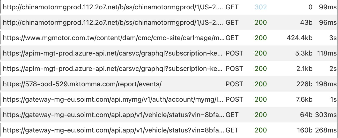

Hi @VaReTaS,
Sorry for late, after trying to add the country code +886 to const.py, still can’t log in.
So far as I know, our REGION_BASE_URIS = EU.
However, Taiwan’s app seems to use another way to log in, not just a simple email or phone. They use this URI to get refreshToken: apim-mgt-prod.azure-api.net/ before your EU API URI, is there any way to use your integration to login, or test?
Thanks a lot.
Hi @PizA
I am not to sure about that connection. Maybe the issue is that TW user tables are on a different server and that’s why they are retrieving the token from there instead of the EU soimt server.
Not really sure if I may find a work around and, even if I did, that would need to be implemented on the API side, not the integration. Let’s see if we can find something and how to handle.
