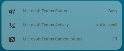

If anyone is interested I have copied over the seemingly abandoned project for to: https://github.com/AntoineGS/TeamsStatusV2
I have applied most of the recommendations from the Issues and Pull Requests, including support for camera detection.
The only “issue” I am aware of right now is that the icons will be the default sensor icon if the service has not sent an update to HA yet, but I preferred that over having unneeded input boxes which is what seemed to be used to get icons to show up.
Pull Requests are welcomed off course!
