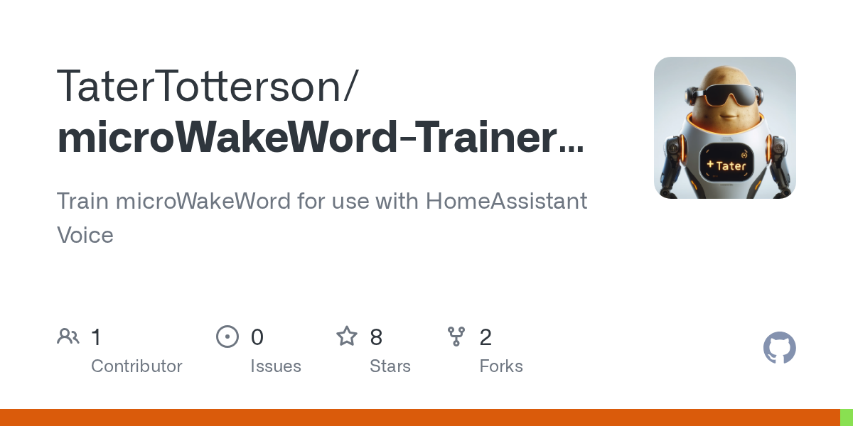

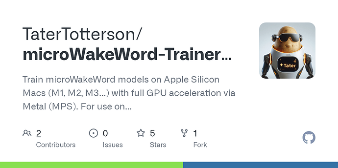

Are you still offering this service? I’ve been hitting a wall for three days straight trying to train a couple wake words. Colob is broken, my mac is too old and it can’t do it in my pi. If someone can train a couple wake words for me i would be greatly appreciative.

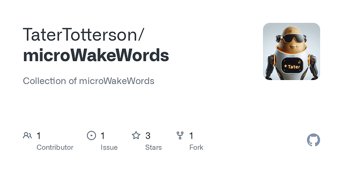

You can do it yourself. See this repo: GitHub - TaterTotterson/microWakeWords: Collection of microWakeWords · GitHub
So I have a couple of wake words that I’m using from the TaterTotterson repos mentioned above…
I have them working on my atom echo for on-device wake word. It’s great! I had to get the full yaml file in the esphome device builder instead of using the packages that link to the github.
